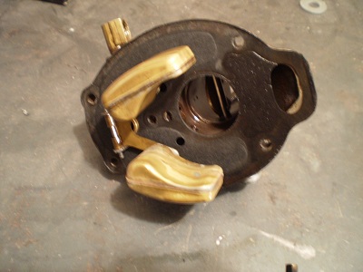

Guess what is missing in this picture

I only see 3 of the 4 bolts that hold the 2 halves together. Is there a needle under the float?

THE TRACTOR !! sorry, I am going to bed now.

GAS!!!!

The rest of the tractor .
 Are yea saying you got troubles with carb flooding?
 Doesn't look like that theres the finger to press against the needle..
Edited by JC(WI) - 23 May 2012 at 9:11pm

I can't see the picture that well without ma' glasses, but the glassbeader, cause' that carb needs a good blasting to clean the rust and debris outta' fuel bowl and the rest of the unit...

Whats missing is the carb that belongs to that plastic venturi. I put together a carb for the D17 for a pull on May 12, and this is why it didnt run that good but still pulled 297 ft.
This is what it looked like when I took it apart
And this is what it should have looked like.
So I guess a M/S carb will run without a venturi.

Doesn't the first pic show a brass venturi? The pic in your initial post that is.

It's been awhile since I rebuilt a Allis carb. Where do you get plastic venturies at ? Are they for pullers ?

I also would like to know about the plastic venturi ??

Lonn; Ya the first pic shows the brass venturi in the parts carb. I got the plastic venturi from Barney Taylor, they were used in the 175 gas.

They will run without the venturi in them. Not good, but they'll run! Yeah, that first pic threw me also (from what I could see without my glasses) cause the venturi is in the carb. Polish up that stock venturi and it'll move some air.  Clean them fuel bowls up and get rid of the crud. That'll make it stop!
