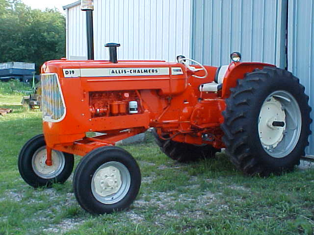

We are about ready to paint our d-17 series 2, was wondering if anyone knew what shade of perian oragne that the d-19 diesel in this picture below. we are looking for that brighter color and i think its persian 2 but am unsure. Also does valspar make these paints or dupont? or do nether. here is a picture of the shade we like it to be

Persian orange #2

     Hey, that is one nice D19D....oh wait...that's my tractor!!   It's Persian #2, that I cross-referenced to DuPont Centari # RS 673.  But sadly, DuPont is phasing out the Centari enamel and I can no longer get that color, but you can cross that # over to another brand that is available to you.  Good luck with your project, Eddie

you got a nice tractor there lol sorry i used your picture, i seen it under google images and said to myself dam thats the color i want!

That would be the color I would have either in a high solids acrylic enamel or a polyurethane.
