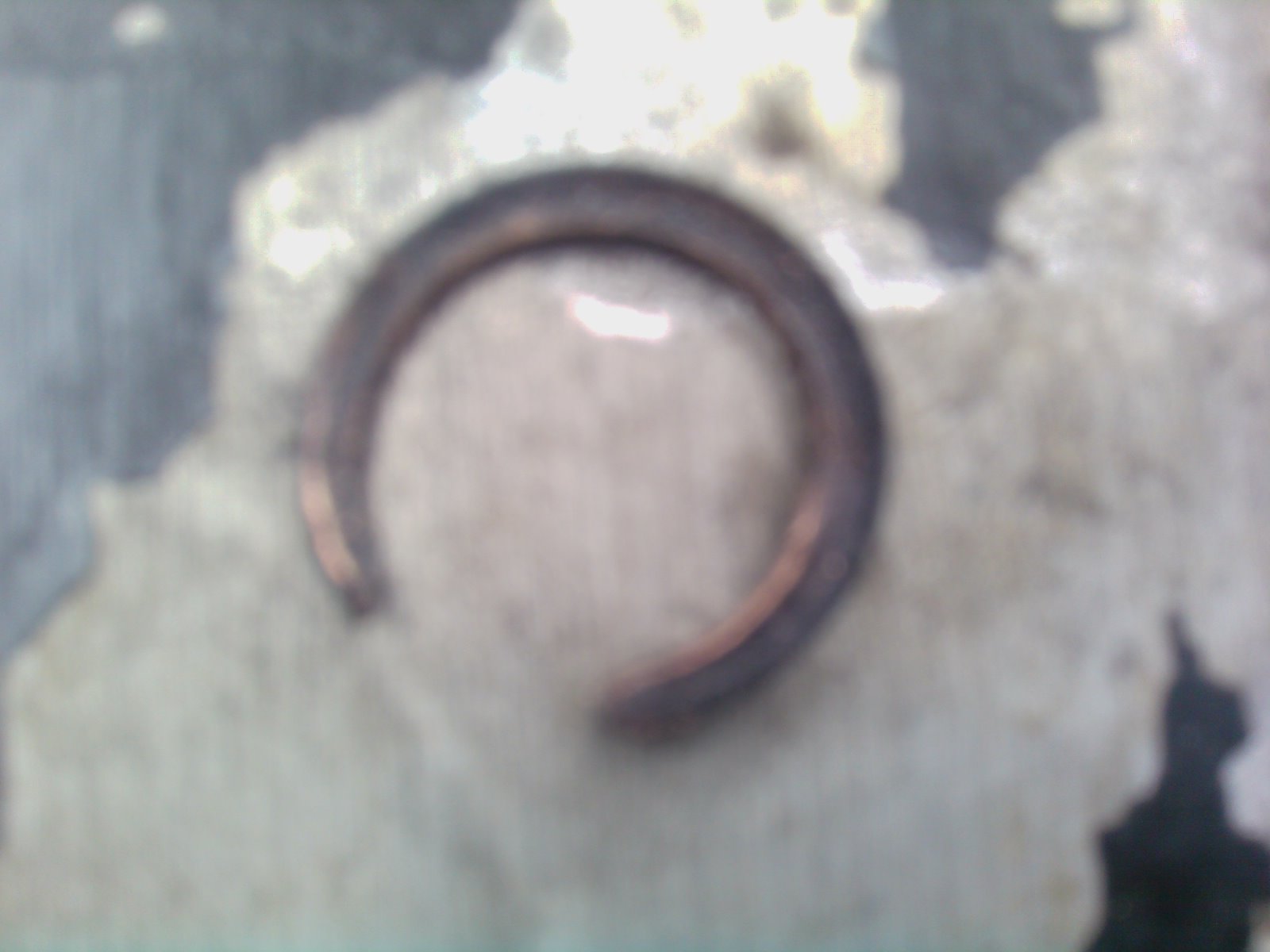

Well, it worked!!! Not the way I had envisioned it but it worked! I went to pull the injector washer this morning and the tap didn't seem to want to work. I went down with a pick and couldn't pull the washer. I determined that there was a washer and if Mack says that the tap works then some how it WORKS! went back down with the tap and a hammerConfused. Yes I had visions of all kinds of stuff ending up in places they are not suppose to be. softly I tapped the tap. Still nothing. OK, what now. Well I decided that if I was going to have to pull the head I may as well have a good reason. BANG! turn with 3/8ths wrench BANG! Oh OH! something is on the end of the tap.
Blew everything out with compressed air. Couldn't find the missing piece. BUT, good news is that upon further examination, the break isn't a new break.
Thanks again for you help.
