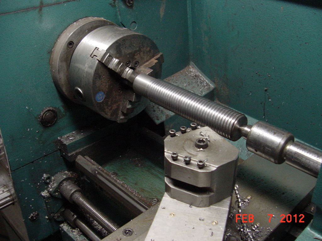

I just finished cutting the thread for my HD6G track adjuster.
1.600 x 5 1/2 TPI Perhaps it is a metric crossover but it fits into my yoke. It is not a 1 5/8 thread. I turned the shaft to 1.590 before I cut the thread. I'm going to weld it onto the old hex adjuster.

The total length of the track adjuster on an HD6G is28.62". What you see in my lathe is the threaded part. I will weld this to the hex part.
The thread that fits in my yoke measures 1.60 x 5 1/2 TPI
If this is supposed to be a metric thread it would be M40x4.6
This is not a normal metric thread either. It is interesting that to be an SAE thread it would be 1.625 diameter. To be a metric 40mm threat it would have to be 1.575 diameter. In each case it is 0.025 off. I'm considering getting some tool steel and making a tap
1 5/8 x 5.5 TPI to clean out the yoke threads.
