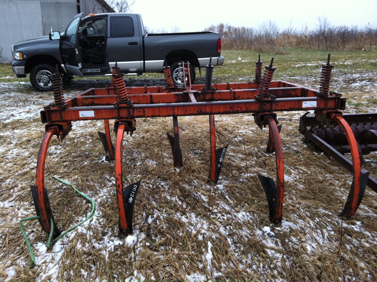

Can you guys see the pic I posted?

Twisted points on that one. Need some ponies to pull that around here. Tracy Martin

that looks like a 600 series same as the 400 series only 3pt. hitch. 400 is pull type.

Same shanks as my 1600 pull type. I pull 9 shanks with my 190XT. Mine have a straight chisel point, about the same width as the shank.  Mine started out with 22 shanks, so I have some spare parts.

Those in the picture are twisted reversable shovels, you can buy those at local john deere store, they also have straight shovels in all different sizes, width, and lenght. Getting shovels is the eazy part, but getting shanks or speical parts will be the hard part just like previously noted above may be the hard part.

That is a model 1600.  We used one just like that very hard for 20 years.  Dealer did custom NH3 application with it before we bought it.  It's been through all kinds of conditions - rocks, frozen ground, mounted on 7080, etc. and never have broken a shank.  We did break one of the lower 3pt mounts and had to weld it.  Remember we were also pulling a 1000 gallon NH3 tank behind it!

Yes Italy Hill pic came through loud and clear. I bought one identical to it around 1983. When I raised the gauge wheels so they'd dig in a foot the old 1566 really barked!

Yeah I picked it up yesterday, in Batavia NY, (2 hours NW of me) It has 8 shanks, and gauge wheels (not pictured). The guy explained the points, I think I'm going to put strait ones on, and I'll probably have to remove 2 shanks to pull it... The biggest tractor on our farm is an IH 884 which I believe is a 70 HP 2wd with loader.. I've always heard people say you should have a minimum of 10 hp per shank...

I am going to start by flipping them over, as in the pic they look sunk into the ground.. They really are just worn off... Picked up 16 plow bolts and nuts, 3X 7" sweeps for the soil perfecta, and some plow bolts for the sweeps too today. Getting ready for spring :)
