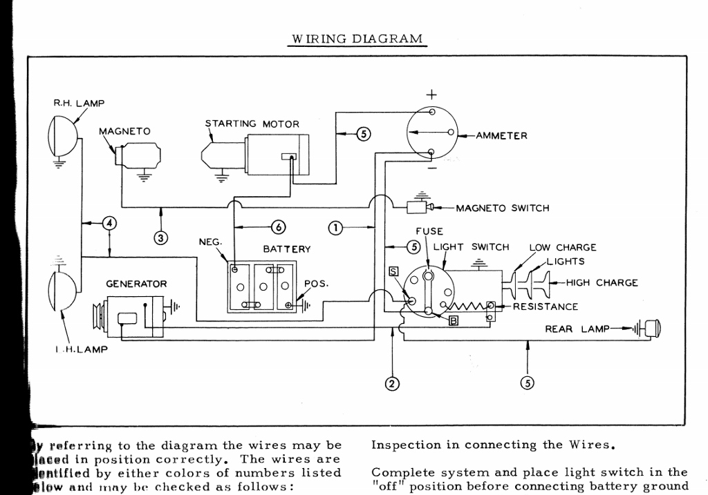

I have the owners manual and operators manual - does anyone know of a better wiring diagram?

this is from WD Service book,  first try of my new scanner
