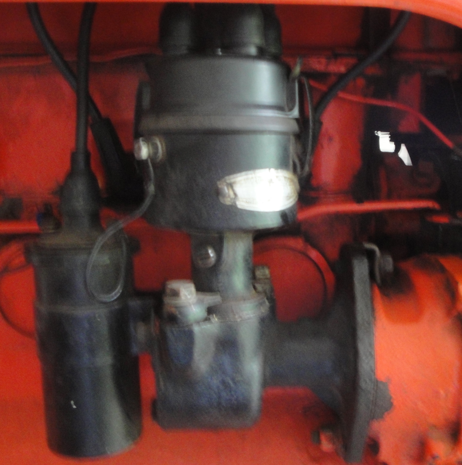

Post Options Post Options   Thanks (0) Thanks(0)   Quote steigerbro24 Quote  Post ReplyReply Direct Link To This Post Posted: 07 Aug 2011 at 3:38pm
  This is what my distributor looks like. The plug wire on the right up front is the wire that goes to the #1 cylinder. It is in a different location from what everyone has been saying but that is where it is supposed to be. Then the wires go clockwise as 1 2 4 3 which is what it is supposed to do but the engine will only make a bang and not start.

Here's how I time them when it's screwed up or didn't have wires when I started the process.
Pull all 4 plugs and wires,Stick your finger in #1 hole, and have someone hand crank it slowly.  Pay attention to when it compresses the air on your finger compared to the rotation on the hand crank.  Try to note the maximum compression spot before it starts releasing.  That's "about" top dead center for that cylinder.  Now look to see where your rotorbug under the cap is pointing.  Rotate the distributor (the bug will stay put) to where it would have just passed one of the posts if the cap were on.  That's now the #1 post.  Put the cap on, and put on #1's wire.  Going clockwise if you were looking down at the cap, put the next wire on the post, and it goes to #2, then the next to #4, and last #3.  This will let you get started.  You may need to tweak timing clockwise or counter a bit to get it to fire, but if you go so far that you have rotated to the next post, it's too far.
Once running, bring to 1/4 throttle or so, and adjust the twist on the distributor for smoothest sound.  You are now reasonably timed.  I go further and go to full throttle (which is actually about 1/2 since you have a governer) and do fine tune.  But I always back the timing from the center of the best sound back clockwise just until I hear a change, and then split the difference.  Too far advanced and you will have excessive heat, and pinging under load, to retarded and loss of power and eventually barking out the exhaust.
