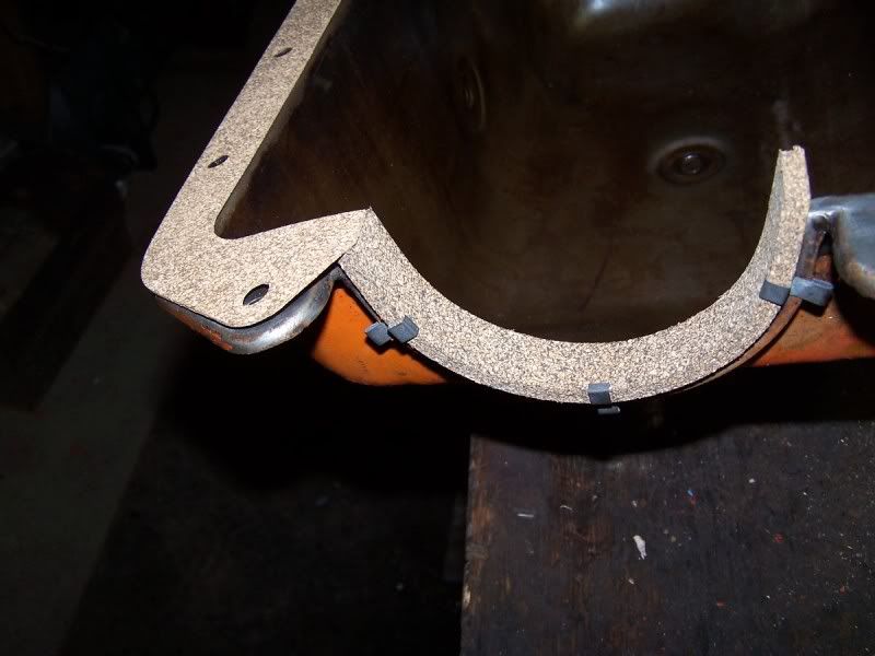

Alright, first off, is it OK to use permatex- Form-a-gasket on both sides of the oil pan gasket?

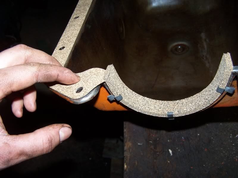

2nd, Which is the correct way to install the arch gaskets to meet the side gaskets? See below...

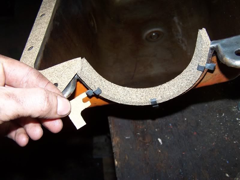

3rd, What are the small cardboard "L" pieces for? I want to put them on the right way, and have no clue how they go on there!

Forget the permatex formagasket. Use a high-tack on the pan. The first picture is right and the cardboard cut-outs look like the rear seal gasket.

First take all the gaskets off the pan and lay it rail down on a flat surface like a good welding bench and check the rails for flatness, Bet ya a pop you have to knock them down flat. I use a hammer and block of hardwood held tight against the pan sides. Once nearly flat check the areas close to the holes for being pulled up due to prior over tightening and if needed knock those areas flat with a big punch. I use a piece of 1" or so shafting or a  long 3/4 bolt will do hitting the threaded end and using the head for a large punch. You can also clamp a shaft or large punch in a vise and hold the pan rail on top of it and knock the holes down flat. Any way you choose to do it it must be done.  Once you have the holes flat check the entire rail again on a flat surface and adjust if needed. NOW you are ready to mess with the gaskets, LOL.  Picture 1 is the correct way to assemble the gaskets. You need a small bead of #2 under the junction of the two. The "L" shaped gaskets go under the rear main caps IF they are shimmed up (The major source of leaks blammed on rear seals and pan gaskets in my experiance is these missing) If the rear main cap is not shimmed throw them away and use a small bead of silicone sealer under the cap as the gaskets can hold the cap up increasing the clearances. Remove the rear main cap and take a look, easy to see how oil can go bewteen the cap and block and out on the ground and where it needs to be sealed up.. Stick the side gaskets to the pan using contact cement. Do not use silicone on cork gaskets as it causes them to move around when you tighten things up making a mess of things. When the gaskets are installed and ready to replace the pan you should see only gaskets, no sealer. Then go to the block and find the area where the side gaskets meet the ends and in those four corners put a 1/4" bead of #2 and put the pan on, now you will be able to remove it without screwing up the gaskets and it wont leaka drop. Thats how I do'em

Alright, without looking at the tractor right now, I still am not sure if I understand how the "L" gasket would help the rear main. I know it does have shims from the last time I looked. Seems like I could only put 2 "L" gaskets on the back, but I must not be thinking about this correctly. Also, butch, whats #2 sealant?

The small paper like gaskets go under the bearing cap on the block, so you would have to unbolt the cap. here is your answer on the number 2 question.

The little gaskets go under the rear main bearing cap, some mechanics don't know and throw them away and then have an oil leak at the rear of the oil pan. I  put the permatex #2 on ALL of the metal surfaces, even the ones under the rear main bearing cap, cheap insurance aganist an oil leak that you don't want. Don't put two much #2 on so that it runs out. Don't over tighten the bolts. The thick cork gaskets will be compressed when you tighten the oil pan, don't cut them off. Butch gave a very good discription on how to prepare the oil pan. Like Don said, Indian Head Gasket Shellac is a very good sealant also.

Does anyone know why 4 "L" gaskets are provided in the kit? Does the front cap get 2 gaskets just like the back cap?
The "L" gaskets should be two different sizes. Engines prior to a D17 had a narrower rear main seal in them, D17's and later use the one with the wider slot in the "L" gasket.

I have replaced the oil pan seal and picture #1 with curved seal butting up under pan gasket is correct...did have to trim flush...one question i have for anyone ..the rear felt oil seals is also sitting in the groove with about an 1/8" above cap..,,cut flush? this i the 2 piece fellt half circle gasket with a neoprene center...any ideas..? don't want to leak
