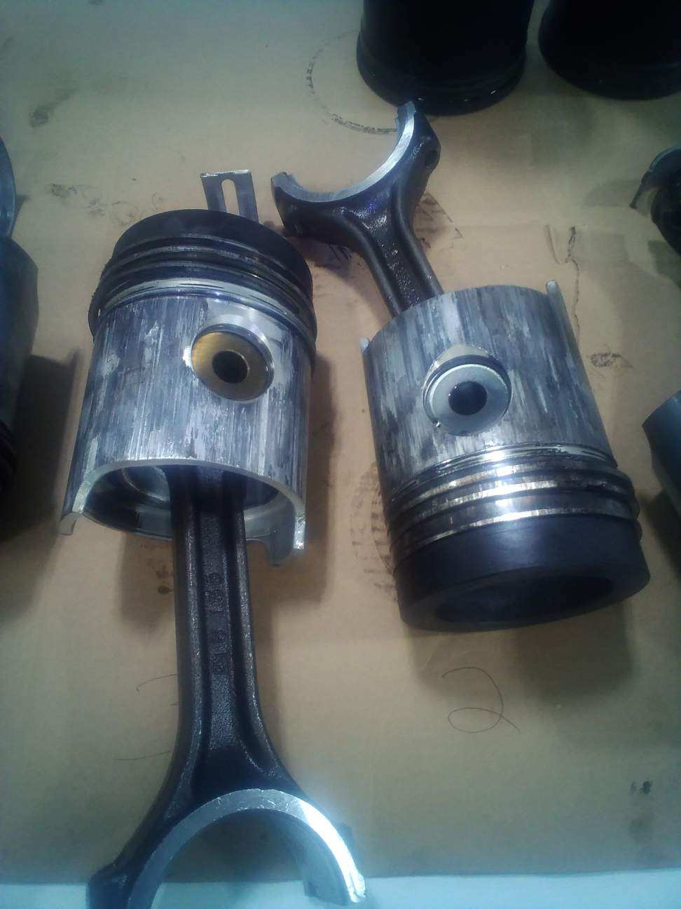

Trying to finish up this customers knocking 220 engine. I've experienced this problem for I'd say 30 years off and on. It's always the engines that don't have piston cooling spraying oil from underneath to keep piston temps down that seem to do this. Replacement pistons and sleeves are parts that work fine in 7040's and bigger because they do have piston cooling, but the newer design piston/sleeves do not like being used in the old non-piston cooled engines. Unfortunately, the old piston/sleeve parts have been discontinued for a very looong time.  All you can purchase now is the newer designed tighter fitting parts.  The older engines used to spec piston skirt to cylinder sleeve clearance at .007". All the newer piston/sleeve kits are .003".  Sometimes they work for years and then, just like this engine, you've got a mess to deal with. I've got a jig made to take my sleeves to a favorite machine shop and have (new or old) sleeves power honed out an extra .004" to alleviate this problem. It's an unfortunate event with no warning whatsoever. My advice is if you are overhauling one of these older non-piston cooled engines, you'd better loosen it up a little or you might get to do it again someday down the road. Pictures on the way.

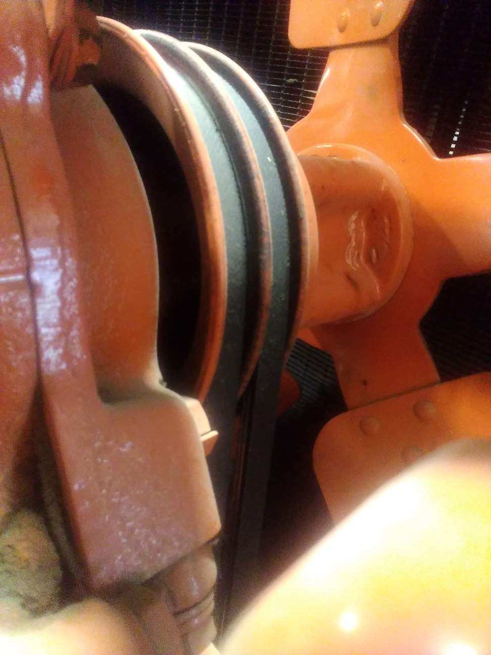

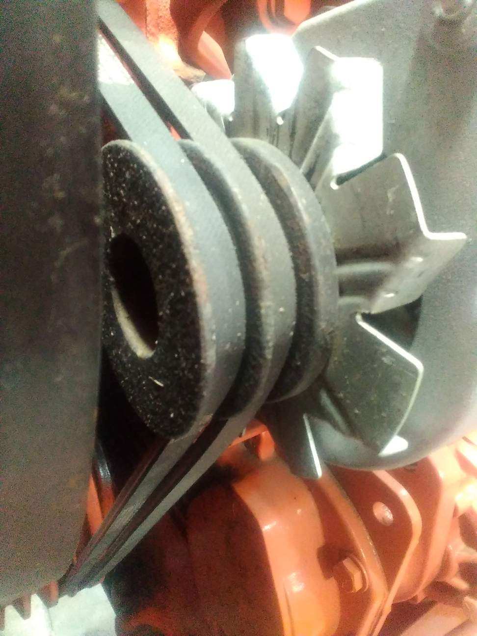

When we have them down we usually plug the oil squirter hole for the old cam driven oil pump gear that is not now used. In theory will up cold start oil pressure on the galley it feeds.
Doc- as to those belts, I use a wrap idler bolted to the pump front cover off an F2 to push the belts in and wrap the water pump pulley more. EZ to install. 71178651 is the pulley needed.  It is designed for matched belts, flat sided.  Have done the ones I own. Doubles the belt life and don't have to run them as tight. Doesn't 100% cure the issue but really helps.
Points: 22772
Post Options Post Options   Thanks (0) Thanks(0)   Quote DrAllis Quote  Post ReplyReply Direct Link To This Post Posted: 15 Jan 2026 at 12:35pm
So, you're pushing in on the fan belts on the injection pump side ?? That would certainly help with belt pull power.  I've got a couple that I have gone so far as to use two "B" width belts, especially for that worn tin water pump pulley. They stand up high, but when tensioned properly they do not slip.  Same thing on any D-15 that I work on. A new 1/2" wide belt instead of the original 3/8" one.
Edited by DrAllis - 08 Feb 2026 at 4:50pm

Post Options Post Options   Thanks (0) Thanks(0)   Quote tbran Quote  Post ReplyReply Direct Link To This Post Posted: 15 Jan 2026 at 9:18pm
Yes, and would probably help if added a 1/2" longer belt and moved it in even more. Wrapping the worn water pump pulley  helps, alternator still slips after long cold starts as it charges wide open.
Points: 8902
Post Options Post Options   Thanks (1) Thanks(1)   Quote Mikez Quote  Post ReplyReply Direct Link To This Post Posted: 16 Jan 2026 at 12:45pm
Tim. Where are you putting the pulley
tbran View Drop Down
Location: Paris Tn
Points: 3633
Post Options Post Options   Thanks (0) Thanks(0)   Quote tbran Quote  Post ReplyReply Direct Link To This Post Posted: 16 Jan 2026 at 4:58pm
Right on the front injection pump cover plate - use one of the bolts - longer of course - and shims. I will try to get a picture posted.  EZ to do. I made a big mistake and put a 6 blade fan on one (210) - 2 shoestrings as Doc calls them just will not pull it at 2400 RPM for long.  I got off the tractor after the first joy ride and was covered with belt chards.

DrAllis when I view your 426 pistons photo(coggonobrien’s), my initial take is “Wow, those pistons have a long skirt!” Just a thought. Could the new pistons lower skirting be easily machined off (removed) to minimize the sleeve’s lower squeeze, especially during cold start warm ups, & still allow them to perform?
During the 1960s, do think the AC engine engineers designed these piston skirts to assist higher diesel cylinder compression, better cylinder heat transfer to entire sleeve coolant jacket, etc,,,?
Edited by AC7060IL - 09 Feb 2026 at 7:57am
  I think the skirts are so long because the wrist pin height is so low, racing engine experts claim the pin should be 1 1/2 from top, looks to be twice that.
Points: 22772
Post Options Post Options   Thanks (0) Thanks(0)   Quote DrAllis Quote  Post ReplyReply Direct Link To This Post Posted: 09 Feb 2026 at 9:41am
The 426 piston length/skirt design is so very similar in design to any DT466, Deere 466, Caterpillar, Cummins and etc,etc,etc. There's nothing different about it for a heavy-duty turbocharged diesel fueled engine. That's not the issue. The issue is not enough skirt clearance when there isn't piston cooling, tight fan belts, clean radiator, functioning thermostats, a muffler instead of a straight pipe and last of all OVER FUELING of the injection pump. Any extra and unwanted heat can swell those tight skirt pistons up too much and once it starts, it becomes a disaster. This kind of thing never happens on light loads. It's when the engine is loaded heavily and for a prolonged period of time. The coolant temp may never even have gotten to the "red" zone, but probably was high in the green. I've never been there when this happens. Just am trying to connect the dots after the fact.  So, the moral of the story is, keep fan belts TIGHT and coolant temps COOL and probably nothing will ever happen. The slipping belt issue can be dealt with using "B" width belts in my experience. If you hear the radiator fan change speeds when running full throttle, the belts are slipping even if they are tight. We can't have that.   Also, piston skirts are the tightest clearance down low and 90 degrees to the piston pin. The pistons (below the pin) are "cam ground" and not perfectly round like one might think.

Doc, earlier you mentioned the worn tin water pump pulley. I replaced my worn tin pully with a new cast iron one and now my belts don't seem to slip because the grooves are narrower. The original tin one was badly worn and a little bent besides.  This was on a 1975 7040.
