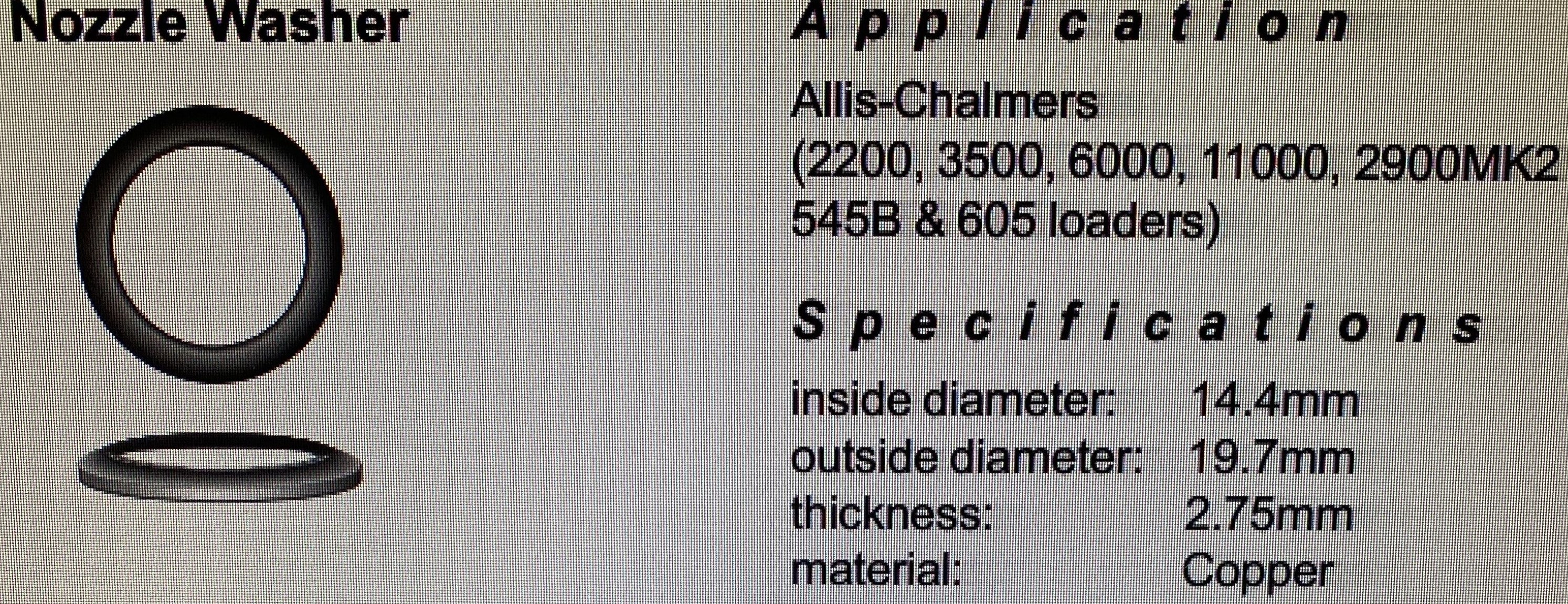

I just found this - some do some don't????   Something has to hold compression in the cylinder... (?)

sorry the computer im on is old - no resize feature. But says 2900mark2  545b/605b

One more time:  Copper injector sleeves in the head do NOT use any copper sealing compression washer/gasket on the injector tip.  If the injectors fit in a cast iron pocket, you need a copper sealing compression washer. Who knows what you have for a cylinder head. In the last 50 years someone could have changed it to something the parts book doesn't agree with. Injectors that do not use a copper washer have a different (tapered) nut on the end of the injector. Injectors that need a copper compression washer have a square nut on the end of the injector for the copper washer to fit onto.

There are no copper sleeves that I am aware of. Hence the washer question. TMK the head is original.

A 2900 doesnt have the sleeves , just the sealing concave washers,, turn them upside down,,

Some later 2900's DID have copper injector sleeves.
