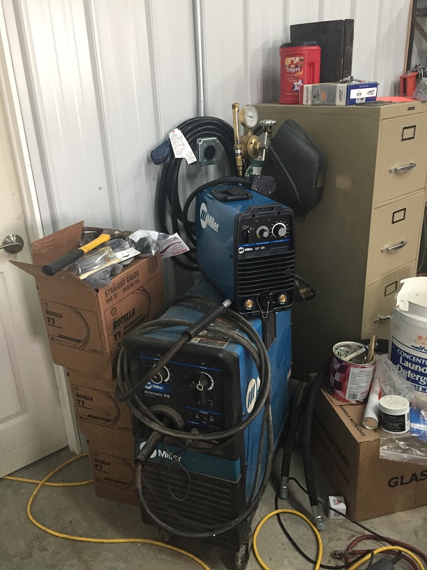

Opted to a 240v Suitcase Inverter welder, Never again will I go AC, Cleaner, faster, better performance.  Old welders had their place, are out of the game these days.  Sitting here on my Miller 210 Wire Feed, another great Choice on My part.
