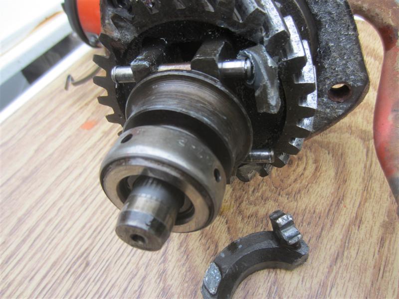

Post Options Post Options   Thanks (0) Thanks(0)   Quote Rusty Allis Quote  Post ReplyReply Direct Link To This Post Posted: 16 Sep 2025 at 8:25pm
Exploded governor weights, while the tractor still gets used, can and does cause timing gear carnage that gets expensive to repair. Quick diagnosis of that possibility can save lots of $$$$. I had a governor weight on my WD puller one time split open at the pivot pin hole/lever area. I caught it right away and shut the engine down. All I had to do was replace the broken governor weight. Had I continued to operate it, all the timing gears would have gotten ate up by schrapnel running thru the gear teeth.
