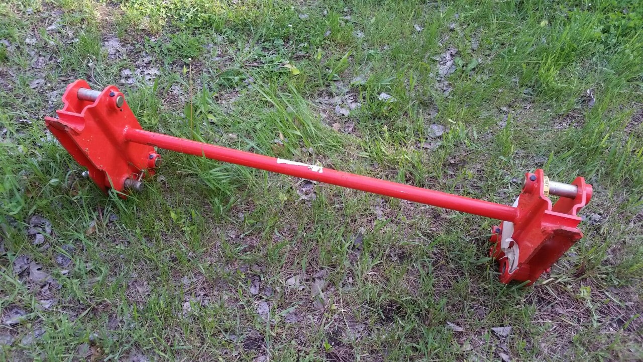

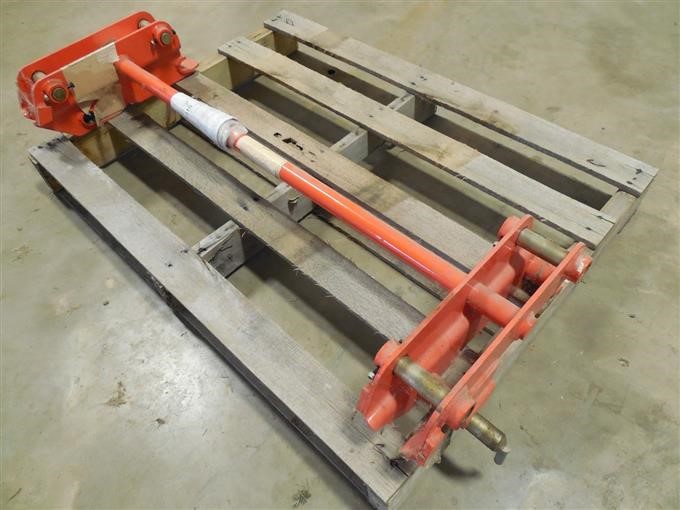

Tracy...Probably this is the concept that Dan mentioned..This is what I found/used...and fit right on after I changed the bar length....One inch pins...originally I had planned to take a 3/4 flat bar that fit the bucket opening and put the sleeves and "U" bracket on each side...That would have not lengthen it so much....This just seemed too easy...nothing lost if it failed...Dale
