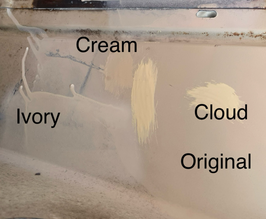

Here’s a picture of the difference between the colors…
Now the cream is agco and it’s like 35-40 years old so it’s possible it’s not right anymore… don’t know if unpainted paint will change in colors after years…
