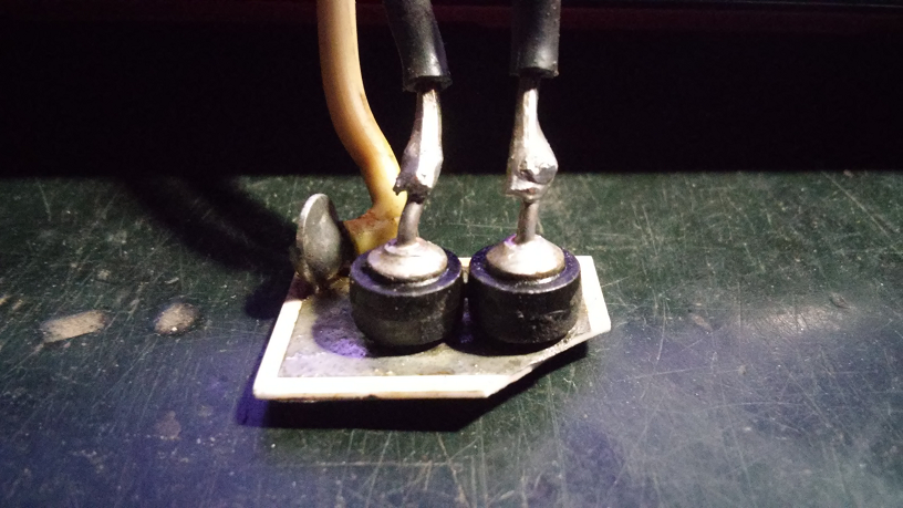

I opened up the old rectifier from an Onan. It was epoxy potted. I was able to put it in boiling water and carefully pick the epoxy away. Not sure what I'm looking at exactly. I figure the white wire is an output and the two black wires are inputs. Black wires (AC) go into two diodes, then out (DC) through the white wire? I figure a guy that knows anything about electronics could build this no problem and for only a few dollars. If anyone on here knows just what this stuff is I'd love to know as well.

You have a half wave rectifier there. Two diodes mounted to a metallic plate which serves as a parallel anode connection, and heat sink to pull the heat away from the diodes. Assembly should be mounted in the airstream of the flywheel cooling fan.  Replace both diodes with 20A units paying attention to the direction. When you impress more positive potential upon the cathode than the anode, the diode conducts rectifying the output through the white wire into a very noisy output DC voltage; good enough to recharge a starting battery.

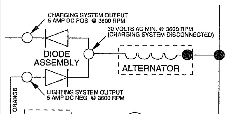

the ones i am familiar with are on the old BRIGGS engines.. ONE WIRE from the alternator goes into the two diodes... One diode changes to DC to charge the battery.. The other DIODE changes to DC to feed the head lights... Head lights dont work off the battery...
Points: 90848
Post Options Post Options   Thanks (0) Thanks(0)   Quote steve(ill) Quote  Post ReplyReply Direct Link To This Post Posted: 20 May 2025 at 1:18pm
have also seen  Two alternator wire in and ONE 12v DC out put...
Edited by steve(ill) - 20 May 2025 at 1:34pm
Points: 90848
Post Options Post Options   Thanks (0) Thanks(0)   Quote steve(ill) Quote  Post ReplyReply Direct Link To This Post Posted: 20 May 2025 at 1:35pm
several variations over the years and depends on size of engine / stator..

I'm not sure how this is done but the mounting plate seems like plastic, yet it's tinned with solder. This entire assembly was mounted to an aluminum plate for heat transfer I'd guess but they don't want it to ground out.
Do you figure just any old 20A diodes? Was also wondering if I got both of them reversed as far as direction, would that reverse the output polarity of the alternator? Just curious there.

The reason for the diodes being isolated from the heatsink on what is probably a silver coated mica wafer is because the common output of the diodes is +ve hence can't be grounded.
I should think pretty much any old diode will do the job on this, not really a critical circuit BUT if you were to reverse the polarity then you'd likely melt the stator as you'd effectively be shorting the battery to ground through it.

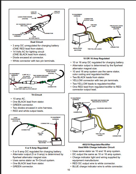

you can buy most of these PREMADE in the aftermarket... If you are SURE the two black wires come from the alternator and the WHITE wire is the 12v OUTLET... then i have used one of these... If your WHITE wire comes from the  alternator and the two BLACK wires are the  12v ( charge and lights)  outputs, then you need a Different type of box... see my drawings in the post above...
Edited by steve(ill) - 21 May 2025 at 7:41am
Points: 90848
Post Options Post Options   Thanks (0) Thanks(0)   Quote steve(ill) Quote  Post ReplyReply Direct Link To This Post Posted: 21 May 2025 at 7:48am
variations..........

Any diode would work but you would need to use discreet components with a PIV, (peak inverse voltage) of at least 50V or so, (doesn't really matter as long as high enough) to be greater than the AC generated voltage of the magnetic field and hence AC voltage from the stator.

What you're looking at in the OP's picture is not a regulator rectifier.
It's just two diodes with the cathodes tied together.  Steve's second image is the most likely arrangement.
There's no significant complexity here... a pair of these, bolted to a plate would do the same thing:
Just remember to electrically insulate the plate, so you don't have it shorted to chassis.
If you want hard-core durability, mount them to a piece of extruded aluminum heat sink material, and mount the material in the direct airflow of the generator's cooling air inlet or exhaust path.
