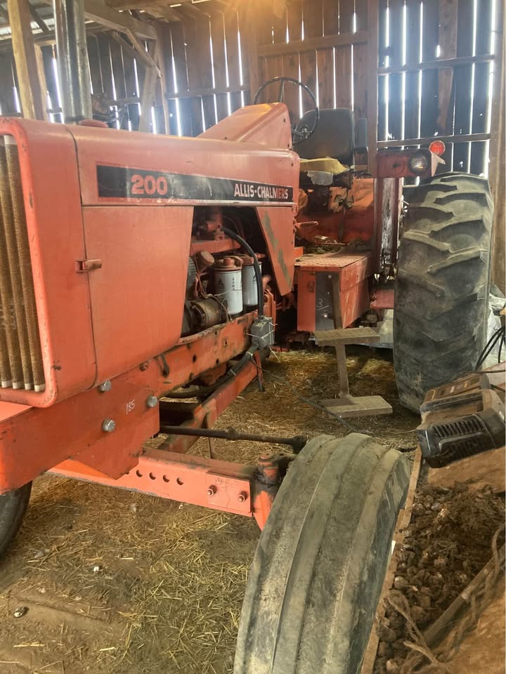

Just kind of looking for another tractor as our 7010 is down for the count. I see an ad for what looks like a pretty straight 200. The catch is the following from the ad.
"Could use high low clutch adjustment and pto valve replaced. Pto works but seems to loose pressure after extended use."
I've tried reading through some other threads here, but seem to be getting more confused the longer I read. By the statement of "pto valve" I'm assuming this one has the hydraulic pto clutch. Something else I've read seems to indicate that the pto clutch and the PD run from the same hydraulic supply. So, is this a possible case of there being some larger hydraulic issue at hand? Other thoughts?

The price would determine whether it should be fixed or left sitting where it is. I can see a complete Power Director clutch and a PTO clutch needing rebuilding and possibly the hydraulic pump. I'm pretty tight and can see this thing getting crazy expensive. So FREE would be the correct price for me.

So, basically no idea until you tear into it. $6k seems a bit excessive for such a fact-finding adventure.

$3500 tops that ones been thru a few auctions- they had hydraulic issues as some were cost reduction models - but get the little things worked out and they are good to go!
