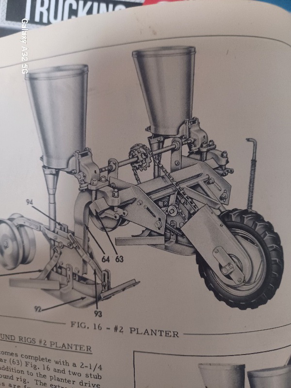

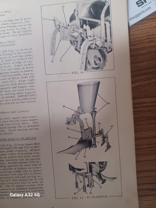

Post Options Post Options   Thanks (0) Thanks(0)   Quote Michael V (NM) Quote  Post ReplyReply Direct Link To This Post Posted: 26 Feb 2025 at 8:06pm
[IMG][/IMG]
John,, the planter I have has this style drive. The book I have doesn't even show the tractor wheel drive, not even in the parts breakdown in the back of the book....???
I've got the #1 planter with the lister bottoms as shown...
And, this book is for 2 row planters,,,3 row bedders,, I'm takin a wild a$$ guess that the tractor wheel drive is for planters bigger than the 2 row
Edited by Michael V (NM) - 26 Feb 2025 at 8:19pm

Post Options Post Options   Thanks (0) Thanks(0)   Quote wjohn Quote  Post ReplyReply Direct Link To This Post Posted: 26 Feb 2025 at 8:49pm
Ah, gotcha now. I'm glad to hear you have what you need. Looks like AC did change to tractor wheel drive for even the 2 and 3 row versions at some point (i.e. the manual I have here) but I think the 4 row always had tractor wheel drive from the beginning, whenever that was.

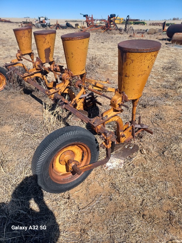

Post Options Post Options   Thanks (0) Thanks(0)   Quote Michael V (NM) Quote  Post ReplyReply Direct Link To This Post Posted: 27 Feb 2025 at 5:45pm
This is a 4 row that I've had for a long time,it's jus to wide to haul around. I'm gonna put this snap coupler hitch on it and display with a WD-45.

Post Options Post Options   Thanks (0) Thanks(0)   Quote wjohn Quote  Post ReplyReply Direct Link To This Post Posted: 27 Feb 2025 at 9:12pm
Neat! You occasionally see bedding/listing equipment around here, but it's not as common. That 4 row you have still has a lot of original paint on it and will look great at a show. What crops did your grandfather plant with it?

Post Options Post Options   Thanks (0) Thanks(0)   Quote Michael V (NM) Quote  Post ReplyReply Direct Link To This Post Posted: 27 Feb 2025 at 9:27pm
The 4 row came in a deal I traded for long time ago with a WD...
My grandad probably planted mostly milo,higeri, cane type crops,, and believe it or not ,, broom corn, which Union county NM was kinda famous for back in the 50's and early 60's..
