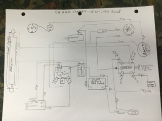

your drawing is too small for me to see details, but it appears to be hand drawn, have a 12 v battery with a voltage regulator and negative ground.. dont see a distributor or mag... something like this ??  What is the question ?
OK.. i see the coil / distributor and push switch on the starter.... my terminals on the coil and BACKWARD....power comes into the + terminal..

This is the ALLIS CHALMERS wiring diagram for magneto equipped B,C & CA tractors. For distributer equipped tractors a key switch and wire from the ammeter is use in place of the grounding magneto switch.

He has a 12 v Negative ground system with a 4 terminal voltage regulator and a distirbutor / coil ignition system..... not close to a factory CA wire system.
