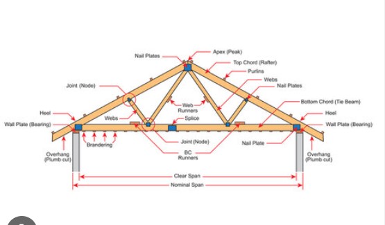

you said your buddy had the legs try to spread and so they connected them at the BOTTOM with a cable and buried in concrete.... another way would be to stretch a cable across the span at the TOP of the legs and ratchet it TIGHT so it acts with the rafter beams above to form an "A" type rafter with bottom truss ( the cable)... that is how most houses and barns keep the LEGS from kicking out..

That red tight cable is the bottom chord of the truss, so cable isn't needed.
Had to go back to the 1st post.....he does say truss.
Now there are two major type of trusses, 'roof ONLY and 'roof with floor'
roof ONLY trusses should NEVER have anything stored on top of the trusses bottom chord. Well OK, maybe 3 or 4 fishing poles but NOT WEIGHT. very,very bad things WILL happen,like the truss WILL fail. BTDT next door.....
 roof with floor trusses ARE designed to,well, have a floor on them and support a certain designed weight (xx pounds per square foot ).

many "STEEL" buildings are made with just a BEAM or TOP CORDS setting on the walls... No lower CORD turing it into a TRUSS.... If he had a BEAM in place of the RED LINE then there is NO PROBLEM with the roof trying to push the walls OUT..... I assume he DOES NOT have a beam at the RED LINE... Adding a CABLE at this point under TENSION would turn the ROOF into a REAL RAFTER with no horizoztal load on the walls.
Yes, you are correct, the manufacturers call it a truss, but it's really a engineered beam with no bottom cord.
A cable across the red line would work, and I hadn't thought of that, although it would limit your headroom somewhat.

would those be 'collar ties' under those 40' steel truss picture ??

i would be very temped to stretch the cable at the BOTTOM and lay it a couple inches below ground.. Gravel floor should cover that OK and no future rust if not "WET".... you could lay the cable in a small trench and pour a cover with  6 x 6 poured concrete 40 ft long if you want the cable "covered"..
