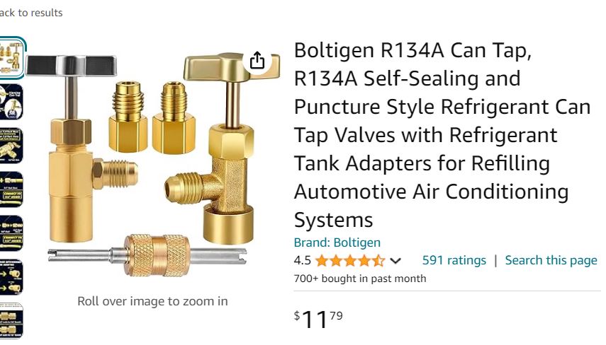

 I tell him there must be a leak in system, but no idea how big a leak system has and can add some freon and see how long it lasts before system leaks down again,,,,?? He comes back with only one of those small cans of R134. I notice that the discharge port in top of can is different that I remember from a while back. This can has a pre-drilled hole with a |valve looking apparatus inside that hole,,,,??
 I tried hooking up my gauges but the "NEW GENERATION" can could not be punctured to release the freon  into the system,,,????

Post Options Post Options   Thanks (0) Thanks(0)   Quote steve(ill) Quote  Post ReplyReply Direct Link To This Post Posted: 22 Jul 2024 at 7:46pm
YEP... a few years back they put a CHECK VALVE in the can so all the goody dont leak out when you onlyuse half a can... and they made it SO YOU CANT USE THE OLD can valve/ .... your hose / gauge set will be OK...!!...... Time to Visit NAPA or AMAZON !

 Well,,Thanks Steve,,, I guess it has been a while that I had not had to use my AC hoses,,,,,LOL
