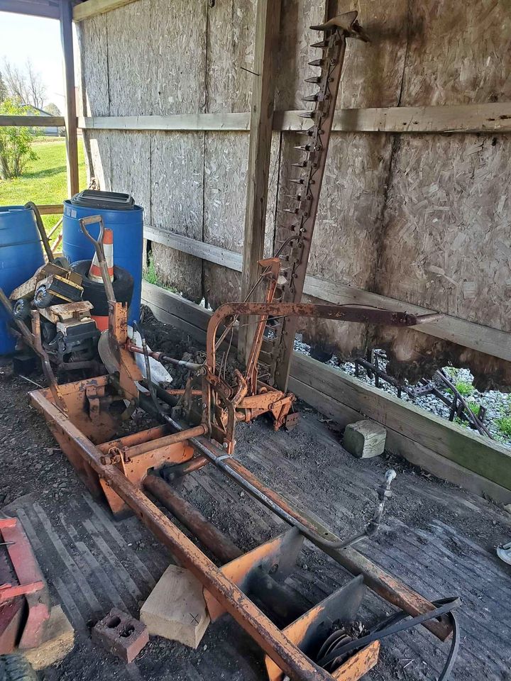

Here is pic of mower from ad. I cant tell if its a BC or no5 but maybe one of you can?Product photo of Allis Charmer cycle bar mower

looks like a #5... curved front hangers and 2 belts on the back..
