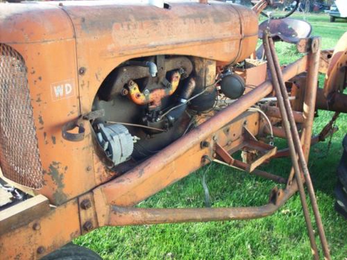

Are you sure about the blue decals on the early WDs?  I thought it was black lettering with the long A and S.  Heres a few shots of my Dad's low hour 1953 WD.  The generator on it is indeed black but I do not believe it is original or not.  I do believe the carbs, air cleaners, generator and starter came to the factory black and were painted orange with the rest of the tractor.  I know the distributors were painted as well as the wires.  My 1953 WD has been on the farm since new and has the original wires on it, they were painted and there is a huge glob of paint on the frame that dripped off of the distributor.  Hard to recreate that in a restoration! lol

Jim,
I think what DrAllis was saying was pre 1952 the decals were blue.
Thanks for the pics.

The book I have says the WD decal bottom should be lined up with the lower hood screw which is where it is in Brian Aharts picture.
