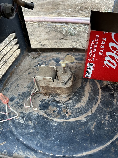

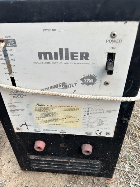

 I picked up a great looking Miller Thunderbolt 225 AMP Style JB-41 Arc welder for a really good price at a yard sale, The STYLE JB-41 is the only'ist numbers on the box. The PO said he stopped using the welder due to the blades on the tiny  cooling fan broke off. He removed the power cord and installed on new machine he bought.
 I installed a short power cord I had and it does weld but I only run it for about 2-3  mins. because of missing  fan blades.

Replace the fan with a "Muffin" fan which is an axial fan commonly available. What is is about 8" diameter? Doesn't have to be a welder fan, just something to move air across the transformer. While apart clean that transformer with solvent and compressed air.

 Some pics,,,,,

 Hey Codger,,when I was doing some study'in on my Lincoln Mig, I did read where some of those cooling fans were 115V and some were 220V,? I think this one has about a 3" daimeter fan,,
 UMM what is a muffin fan,,,,,,????LOLLOL

JOE !!! I gots that same welder with the same problem !!.. Yes, the fan was 240 v.. I looked on AMAZON for a "exact fit" .... MUCHO $$$ ..... I finally took a 120v muffin fan i had ( thats a small box fan) that was about 6 inches in diameter and STUFFED it into that space.. ITS TIGHT !!... But i gots LOTTS OF COOLING !!..
You might want to set a 20 inch box fan next to the welder and "TEST WELD" to make sure the COOLING solves your problem and you dont have ADDITIONAL WEAK parts ??

 OK,, I decided the idea of doing a "Trial Run" to se if there is any good reason to keep on working on this machine. There is NO tag on the machine but writing states it is an A/C machine. The only numbers anywhere are "Style JB-41" stenciled at center top of face.
I had to machine some quick attach pins to adapt my Lincoln lead ends to the Miller ports and I notice the LOW port has been removed entirely. I then see where the PO had taped up the big copper wires that were on the outlet port from the Transformer,,,Hmm? Bad JUJU,,??  My thoughts here are that the red plastic quick attach port for the LOW had broken and PO just removed it and taped up the big copper wires inside box from Transformer,,?
 Got everything ready and turned that mother ON,,,,,! The fan motor has bearings gone and sounds terrible, so I disconect the power cable and disconnect the cooling fan,then try it again.
 The heat setting crank aT TOP of maching is quite stiff and will need some cleaning of the brownish varnish looking "stuff" on the sides of transformer and if possible will have to be taken apart to clean that varnish stuff before the sliding UP and Down part to adjust heat settings easier.
 I then notice that ,,,,,,EITHER the "Black Plastic SLIDING part in center of transformer and controlled by the Crank is a TWO piece or it has broken right in the center in the straightest crack you ever seen,,!??
 I set the heat at 90 and this will weld quite nicely with 6013 in 1/8" but DOES stick a few times,,,,maybe get some 6011,,??
 IF the big black plastic adjuster on the transformer is not broken,,,, then maybe there is a decent welder hidden in this project,,,??
 Steve has given me a link to a 240V cooling fan that will take just a pair of minutes  to install,,,,at $26 plus a replacement port for the LOW CAN'T BE TOO EXPENSIVE,??
 What ya'll think,,,,??
