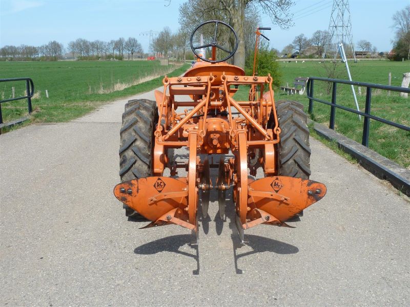

Anybody know about these plows

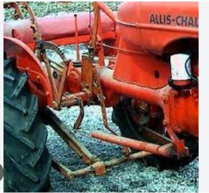

does some one have pictues of the mounting in the front

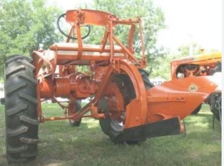

Hud... most of the plows just have a PIN hitch at the front.. It pins to a horizontal bar running side to side in front of the wheels. ... the bar is attached to two pivot arms and the bar can be raised or lowered with a hand lever that comes up by the gas tank.. Look at the photo above, and this one below..
