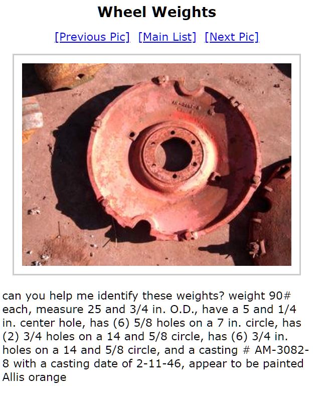

I have a wheel center with a stamping of am -3082 -3 that I bought at auction years ago. Can you help me identifying which wheel center goes to which tractor

So, it's a cast iron piece that is more than one inch thick ?? Does it have a splined hole in the center ?? If so, I'm thinking a model "B" or "C" tractor.

GOOGLE search shows this photo...........

WC or RC wheel center.

Post Options Post Options   Thanks (0) Thanks(0)   Quote steve(ill) Quote  Post ReplyReply Direct Link To This Post Posted: 10 Jun 2023 at 8:08pm
i assume the -8 means the year of manufacture.... if 8 is a 1946, then 3 might be a 1941 date...  so the FIRST one was about 1939 ....... that lines up with the WC.

It definitely has a three on the end. The center circle is smooth. Going back to what Dr. allis question whether it was splined or not. So the consensus is probably a WC?

1939 or newer WC rear wheel center, not a wheel weight.

WC, WF or RC all take the same center.
