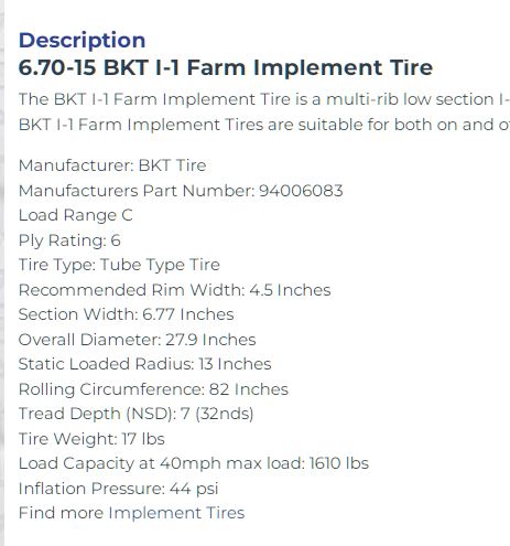

Post Options Post Options   Thanks (0) Thanks(0)   Quote steve(ill) Quote  Post ReplyReply Direct Link To This Post Posted: 20 May 2023 at 8:10pm
internet data on DIAMETER and RIM SIZE...
