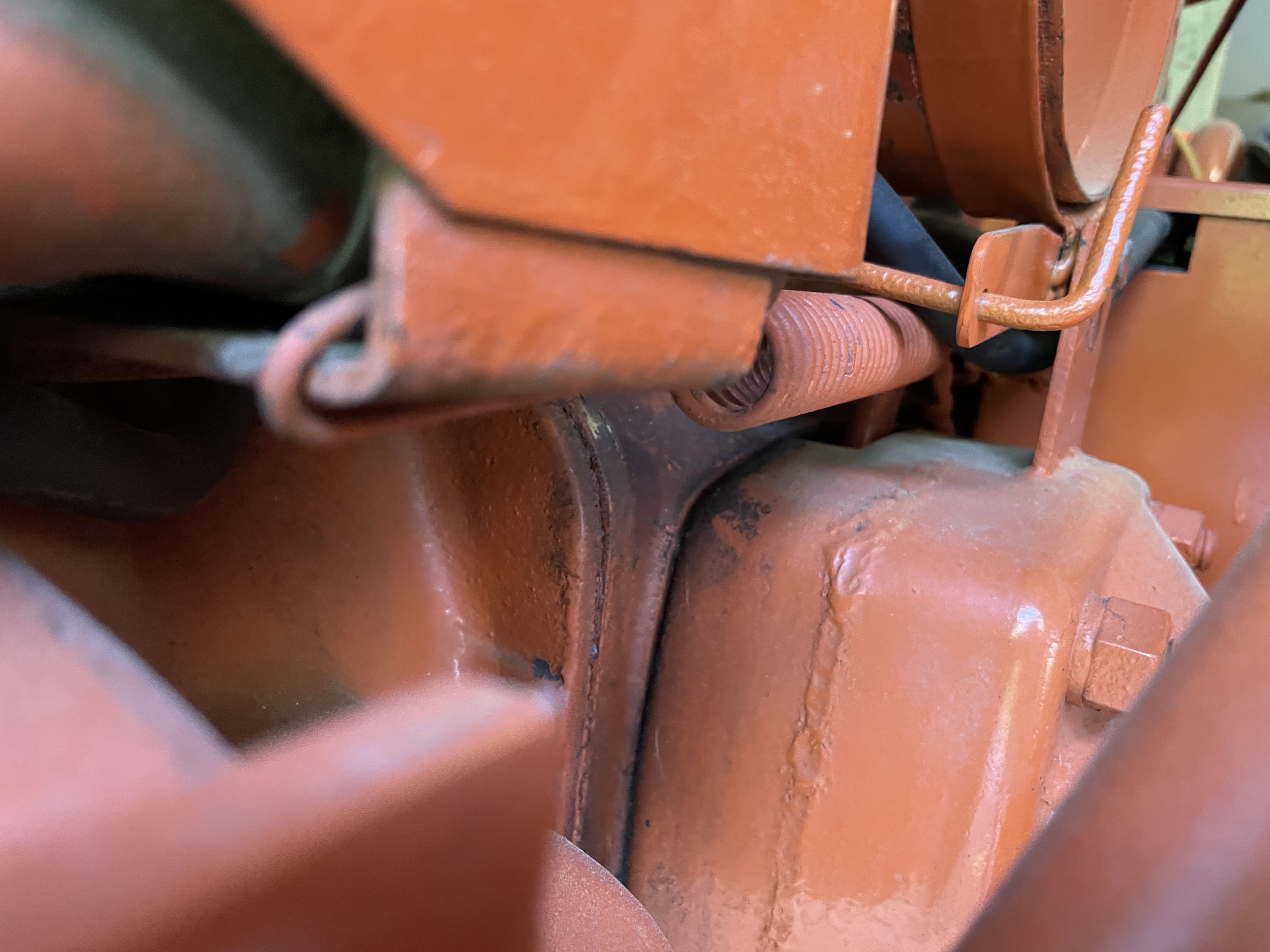

I need some help from the model G experts here on the forum. I am in the process of restoring a 1951 model G. When I removed the fenders and gas tank the brake pedal return springs were just laying on top of the transmission. I know where the springs attach to the pedals my question is where do the springs attach to the tractor? Any information and or pictures would be greatly appreciated.

they pass under the radiator and hook around the bottom of the radiator frame
