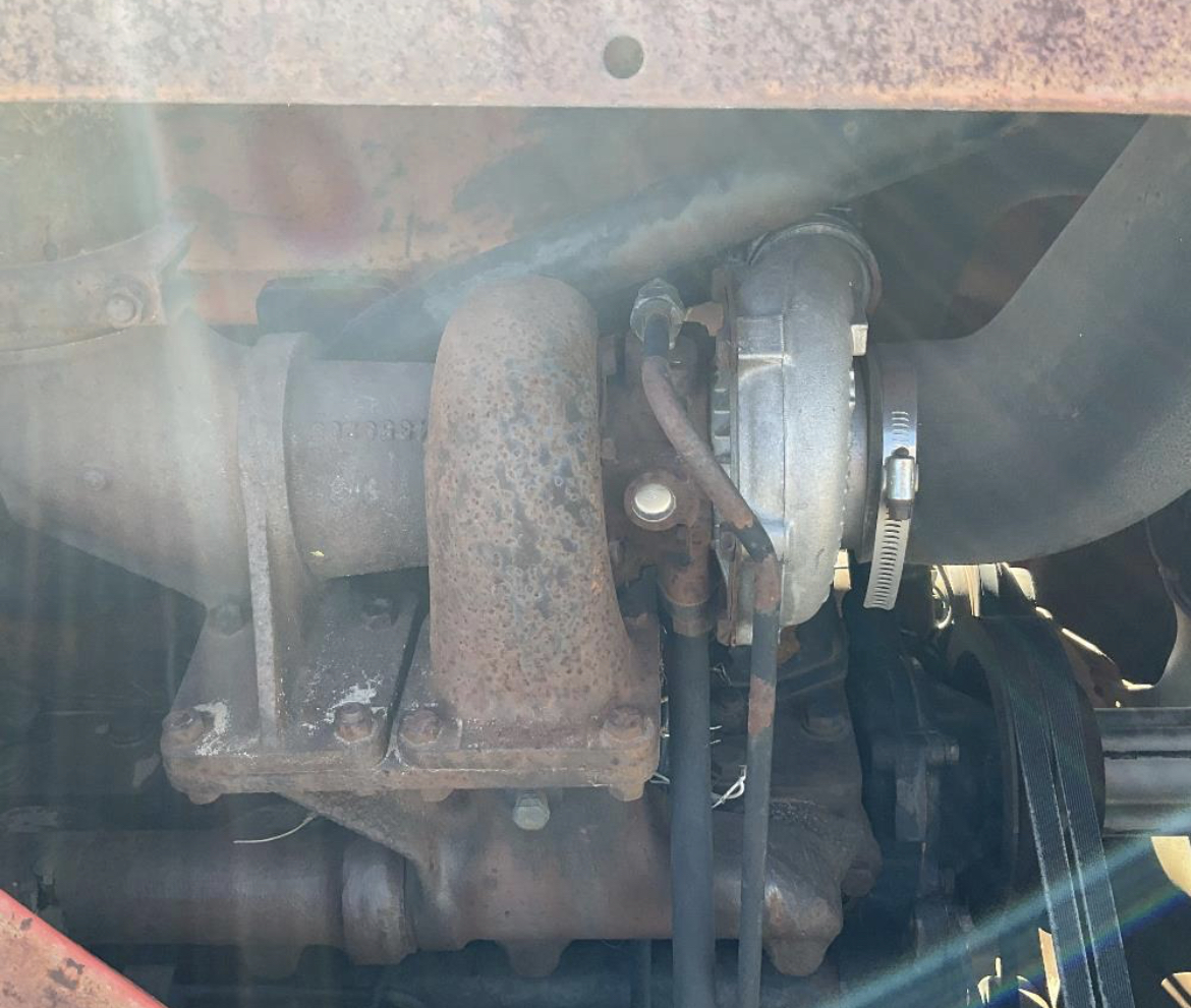

Haven’t got it yet because it’s on an auction and only if it goes cheep….
Don’t even know if the engine is any good being the owner thought he blew it up…
Said it blew black smoke all over and he shut it down, but that was 25/30 years ago.
Points: 22811
Post Options Post Options   Thanks (0) Thanks(0)   Quote DrAllis Quote  Post ReplyReply Direct Link To This Post Posted: 02 Apr 2023 at 7:31am
Might have just been the turbo, but surely will be an OH now. The muffler didn't remove itself.

I did notice it has the famous crack in the manifold but it is also missing the engine dipstick and bottom of the air cleaner…
