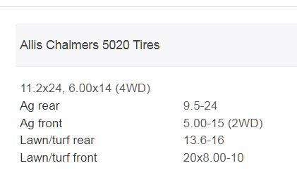

Points: 90948
Post Options Post Options   Thanks (0) Thanks(0)   Quote steve(ill) Quote  Post ReplyReply Direct Link To This Post Posted: 14 Mar 2023 at 4:25pm
From a MachineryPete site...

Post Options Post Options   Thanks (0) Thanks(0)   Quote ac160 Quote  Post ReplyReply Direct Link To This Post Posted: 15 Mar 2023 at 7:02am
I would guess 11.2-24 from what my manual states.  My 5020 has the other option in the manual, of 13.6-16 turf tires on it.
