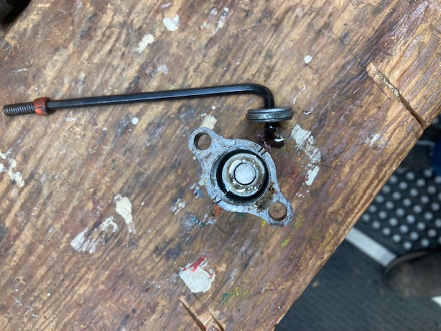

Post Options Post Options   Thanks (0) Thanks(0)   Quote captaindana Quote  Post ReplyReply Direct Link To This Post Posted: 09 Feb 2023 at 3:39pm
Maybe difficult to see but inside the plunger cap I removed are these 4 washers, one of which is very thick. Book doesn’t show any, what gives??

Post Options Post Options   Thanks (0) Thanks(0)   Quote DSeries4 Quote  Post ReplyReply Direct Link To This Post Posted: 09 Feb 2023 at 3:53pm
When you said the linkage is free, did you just move the position control and traction booster levers and call them good?  If I recall, the 185 has 3 pivot points in the linkage.  You have to crawl under the tractor and try moving them by hand - you may need to disconnect some of the other levers to see if these pivots are not stuck.  My 185 had a pivot under under the right floor pan that was rusted up and would not move.  Got it freed up and checked all the other spots for easy movement and the problem was solved.  Taking apart, cleaning and using anti seize is the best solution.
Only one of my tractors had a valve that was slightly stuck.  All the others had problems with the linkages.

Post Options Post Options   Thanks (0) Thanks(0)   Quote DrAllis Quote  Post ReplyReply Direct Link To This Post Posted: 09 Feb 2023 at 5:13pm
No spring inside of that aluminum cap ??
captaindana View Drop Down
Location: Fort Plain, NY
Points: 2609
Post Options Post Options   Thanks (0) Thanks(0)   Quote captaindana Quote  Post ReplyReply Direct Link To This Post Posted: 09 Feb 2023 at 7:27pm
Yes Dr a spring and 4 washers, 1 of them really thick
