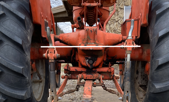

Quick question and some advice needed on my D15 II.  Per the pic below, my 3 pt arms are not level.  I'm assuming I need to remove one and "clock" it accordingly.  Looks like I will need to pull the fender to get some room but what will I need to get the arm off?  Any recommendations on type and size of puller?  Plan on using heat?

Looks like the right one is a little high, if they both are at the lowest point of travel.  IIRR, the arms are on a splined shaft, with a simple snap ring, on the inside and outside, iou just need the right screw driver or small cold chisel to pry them out, till they slide over the splines...  Hard part is, if they have rusted to the splines, you may have to heat and beat to get them to move. Heat then tap inward then outward, once you see movement, you are most of the way there!Wink

look close at the splines between the arm and the case... could be assembled wrong, or could have been overloaded and twisted the shaft... are the splines STRAIGHT ?

You'll likely not be able to remove either arm in chassis without damaging them and 3 point hitch parts are very scarce. Have you determined which arm is incorrect ??? That would be first. I think I would remove the lift arm housing and drive out one roll pin and then pull out the shaft/lift arm that you want to change. It can be disassembled from the inside as everything is covered with oil and a slip fit, unlike the outside spline connections. Place the arm/shaft in a press using a bearing splitter or a thick wall piece of pipe and a bearing splitter. Torch heat will probably be needed, but be careful. I hope the shaft isn't twisted, altho the shaft itself should be the same as a snap coupler tractor.

I took a look at the picture, again.  I don't see anything twisted.  But then again, I am looking at it from some 1400 miles away, through a computer! Look at the right crank, looks newer, possibly that is the one that was assembled wrong.  That is where I'd start, hoping that if it was assembled wrong, more recently than the other one!Wink

someone's attempt to “level” a plow?
I’d guess the right side has been moved.

One twisted. One spline moves it alot more than what it is.                  MACK

I agree with Dr Allis and Mack. My guess is it is twisted because I had this happen to me when I was a teenager. I backed out of the furrow in hi-reverse with dads heavy Oliver 3 bottom plow, when the left tire went down into the furrow and came back up it was a violent shock and it twisted the shaft inside the rear housing. I had been using low range knowing I needed to be going slow up to that point. We removed the plow in the field when dad got home from work and took it home to remove the rear housing. I can remember us taking it to the dealer and the owner looked at dad and said how and the **** did ya do that? Dad pointed to me and said ask him? I was so embarrassed. I love to plow and that taught me a valuable lesson.

You all are awesome, thank you for all the feedback!  With that said...NUTS!  I was hoping it was a "quick fix" requiring just a minor adjustment but now it potentially being twisted has me wondering/worried.
The tractor is 4 hrs away on my farm and it will be a couple of weekends till I get there to work with it.  I'll get some more pics for you all to help analyze but in the meantime I'll plan for the worse.  I've only recently acquired the tractor so not sure what happened previously to create this situation.
At the end of the day, this is a hobby tractor for a hobby farm.  Plan was to utilize this tractor for brush hogging and misc chores.  This tractor also helped me round out my "D" collection (D10/D15/D17/D19) and with a recent engine rebuild and freshening up, I'm not wanting to give up on it.

Guess you could still use it the way it is, just shorten the low side or extend the high side to level.
 Have one D17 that somebody set the lift arms up one spline, raises everything up higher for sure. Don't remember it causing any problems set that way.
 Just looked at a D14 book and shows the lift shafts are 2 piece and pinned inside so they are not able to be one spline off. So, it is either one arm set one spline off outside the housing, or the shaft twisted. So then comes the question, which shaft?

I'm thinking the right one has to be 'reclocked',as the left is the lowest one.
Before removing the HEAVY,AWKWARD section of 'rockshaft', I suggest trying to push the arm off by installing a series of 'wedges' between the arm and the casing. I'd hate to read that you whacked the arm once too hard and broke it.

If one of the shafts is twisted, it would likely be the one that is the lowest. What are the odds of twisting one upwards ???

Ya, I don't know how you would twist one up.  About the only way would be to hit it with another tractor or back into something juuuuuuuuussst right.  Doesn't seem to likely!

Other than the appearance from a looks standpoint driving you nuts.  If it will do what you need it to do by adjusting arm length, you might want to think twice about a fix.  Just a thought, the older I get, the lazier I seem to become.

Drain oil.
Remove PTO shaft.
Inspect shafts for twisting.
Inspect ram coupler for damage.
That difference is less than one spline.

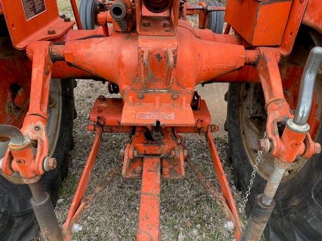

This has been quite the discussion and boy am I learning from you all...much appreciated!  I looked through my photos and happened to find this one which shows the arms from another angle.  They don't look like they have been touched before.
I did remove the adjusters and brought those back home with me to clean them up as they wouldn't turn very well.  They work great now so when I'm back up, I can put them on and try to adjust accordingly.

The left lift shaft is longer than the right lift shaft, so it would be more likely to twist than the shorter one. Just so happens the left side is lower............hmmmm.....

LIFT Shaft replaced with a different series tractor whereby the splines are not cut to the same orientation??

Curious, I measured dad’s series II D15 from the floor to the center of the bolt of each arm. The left side is 1” shorter than the right if the paved driveway is level where I measured it from. There is some obvious wear at the knuckles so it may be less.

The LEFT (p/n 70227791) and RIGHT (p/n 70227792) are the same for D14s and D15s.
They are different lengths due to the Crank being offset to clear the ring gear.
Each shaft is drilled for a roll-pin; as is the Crank to match.
It appears from the shaft drawings that there are 15 or 16 splines on both ends.
For production purposes, these would all be clocked the same; otherwise there would be a never ending problem.
If at 16 deg, one spline would change the "clocking" by 22.5 deg
That's a lot of movement at the end of the lift arm.
The OP could measure his tractor's lift assembly as did AC720Man to see if the difference is that great.  If someone knows the exact count of splines and the distance from the center of a lift shaft to the center of the bolt that AC720Man is referring to, we can calculate what a one-spline index change would make.

your right Dwight.... the SIN of 23 degree is .37 ...... so lets assume the arm in 15- 16 inches long...... that means when you move the arm 1 NOTCH... you move the pin between 5 and 6 inches .............. his photo looks more like 2 inches... so it is TWISTED.

This view makes it look not nearly as bad as the first picture posted.
One thing the OP could do is use a carpenter's square and straight piece of something to check the height of the arms.  Check from both directions.
Another thought..... if the broached splines on the arms are not clocked the same, that might cause the difference. But again, this would not likely be the case in production.
