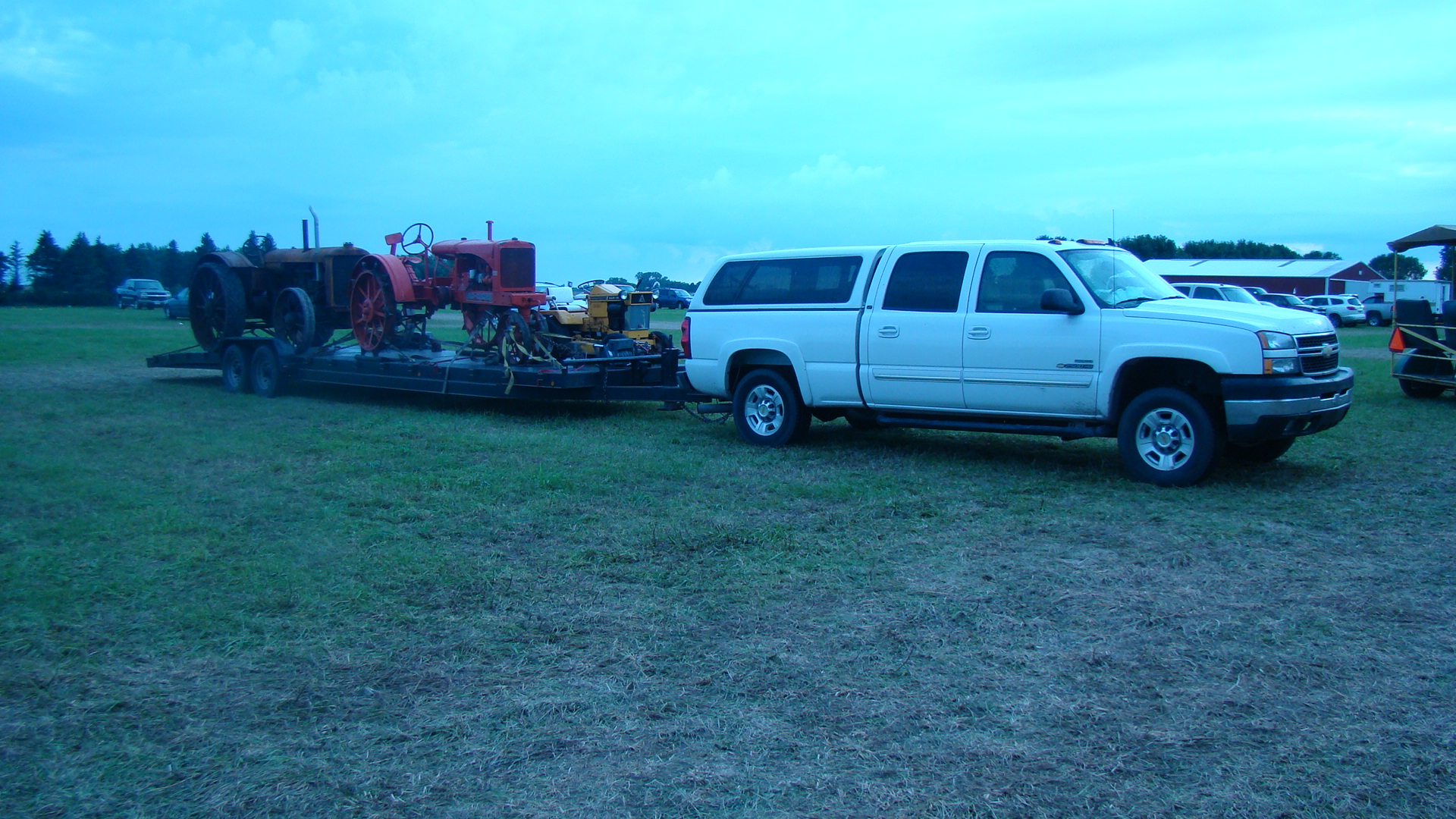

I know I am happy with the milage my 07 Dmax 2500 4dr 4x4 gets. I average 18 mpg at 70 on the cruise control, I can easly get 20-21 mpg  by feathering the throttle at around 70 and get arund 13 mpg pullng my 29 model E with a 15k trailer.
In the pic below, in Albert City IA, I drove back to OKLA running 55 because of the load  (a little over 12k lbs including the trailer) and each tank figured between 12 and 14 mpg. And yes, I am tongue heavy here, I moved the load back right after this pic was taken.
I installed a PPE 3 stage program at level 2 and an adjustible waste gate cpntroller and gained nearly 3 mpg.   I have been very happy with the power and milage from this combo.  No exhaust or airboxs mods and I have ran it this way for 40k miles.
  I did crank it up one time (program manual doesnt recomend this because of restricted exhaust) and ran it through the quarter mile one time and ran a 14.68. I came off the line in 4wd and switched out in 2nd.
