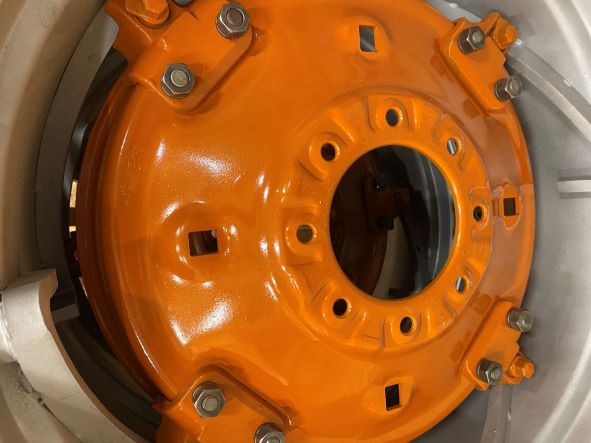

Purchased 1 gallon of PPG Shopline Acrylic Urethane 60080 persian orange on Sept 30th from Colours Inc PPG dealer in Lincoln Nebraska. Price was $314 per gallon. Using medium topcoat hardener JH6680 and reducer JR506. Sprays very nice. Picture shows it applied.

 TOM (NE) that rim you painted looks great. Would that be a Persian orange 1 color?

Yes it is PPG coded 60080 , persian orange #1. The PPG Shopline line is only available/sold through PPG Platinum Distributor dealers. Been using this paint line since 2019 to paint my Allis Chalmers projects.
