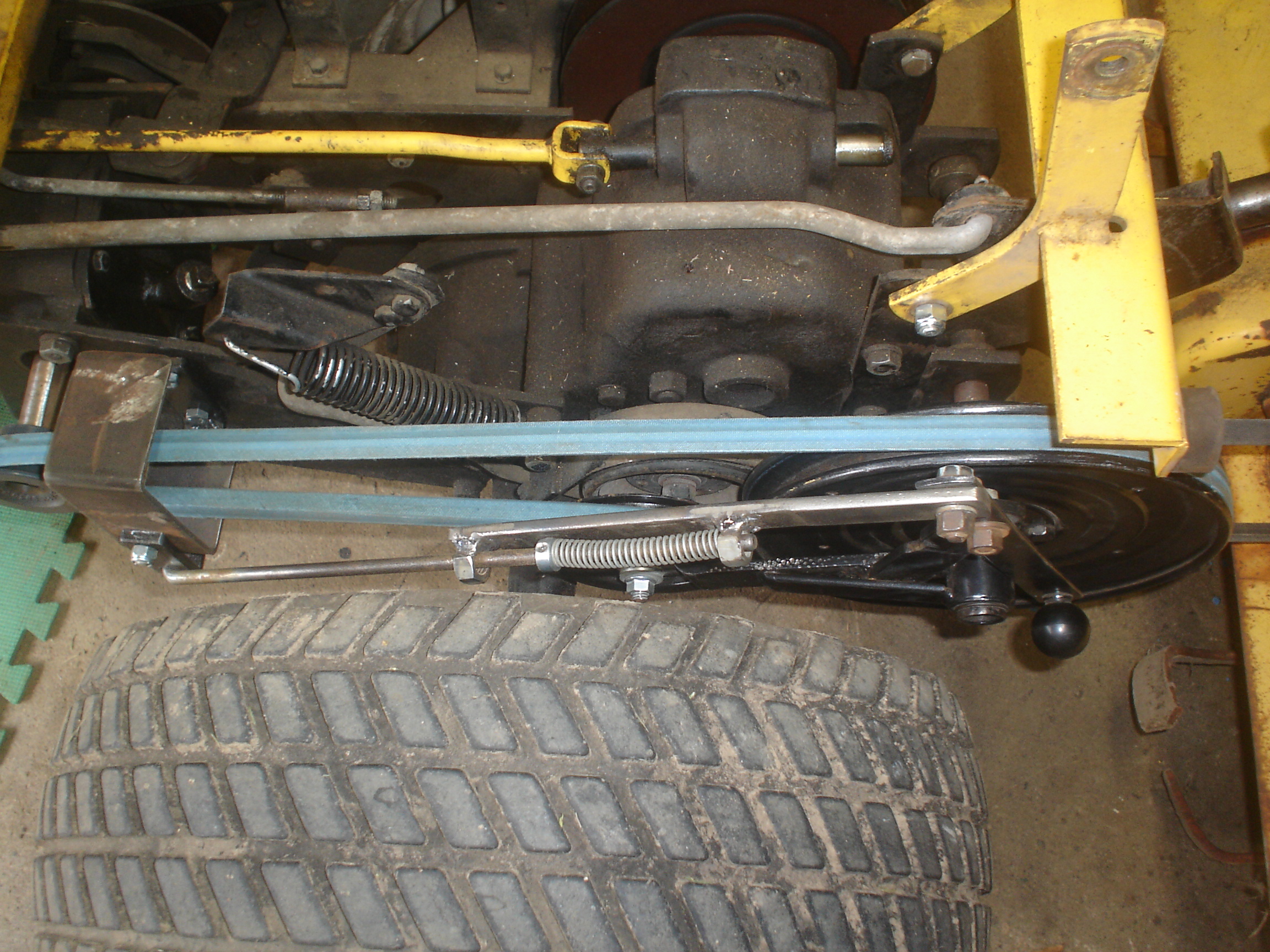

Post Options Post Options   Thanks (0) Thanks(0)   Quote jaybmiller Quote  Post ReplyReply Direct Link To This Post Posted: 21 Sep 2022 at 4:27pm
here's what I have.... had to make the 'tensioning' stuff
problem is not enough tension AND no 'disengaged'

Post Options Post Options   Thanks (0) Thanks(0)   Quote LionelinKY Quote  Post ReplyReply Direct Link To This Post Posted: 22 Sep 2022 at 4:15am
Belt is either inside out AND/OR too wide to begin with. It doesn't look like it is down inside the pulleys at all like it should be. That right there would make the correct length belt run too tight thus not disengage.

Post Options Post Options   Thanks (0) Thanks(0)   Quote Mikez Quote  Post ReplyReply Direct Link To This Post Posted: 22 Sep 2022 at 9:32am
So it won’t tighten up properly and won’t fully disengage ether. Are the pulleys factory. The disengagement could be the belt guide. I think we have a nos belt. I’ll try to find it to see what it looks like

Post Options Post Options   Thanks (0) Thanks(0)   Quote LionelinKY Quote  Post ReplyReply Direct Link To This Post Posted: 23 Sep 2022 at 2:16am
Mine will still spin also when disengaged if the tiller is raised but it stops immediately if I put the tiller down onto the ground. I think that is still normal. So, is yours also stopping (belt slipping/burning) with the lever engaged with the tiller down??

Post Options Post Options   Thanks (0) Thanks(0)   Quote LionelinKY Quote  Post ReplyReply Direct Link To This Post Posted: 24 Sep 2022 at 3:16am
So, tiller down on the ground with pto engaged and it still stops the blades???  Which belt is slipping/burning??? The pto engage lever only provides tension for the big belt from the BGB to the big pulley. The smaller belt is always under full tension adjusted by the t-bolt adjuster on top of the tiller.

Post Options Post Options   Thanks (0) Thanks(0)   Quote jaybmiller Quote  Post ReplyReply Direct Link To This Post Posted: 24 Sep 2022 at 6:57am
yes, the big belt/tension lever setup is the problem, not the small belt.
