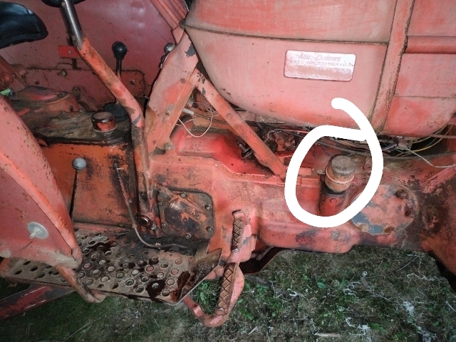

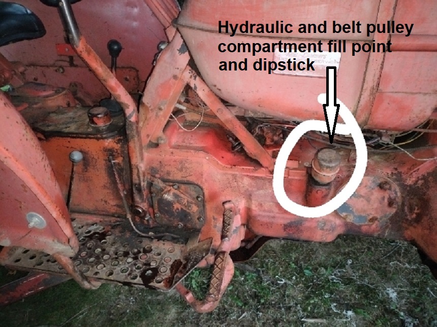

The plug directly down from the clutch pedal pivot shaft is for the Power Director clutch/PTO gears. Takes 2 to 2 1/2 gallons to the left of the gear shift.   You've removed the plug to the hydraulic sump, which is another 2 1/2 gallons. Fill under the gas tank on the right side for series 1 and 2  D-17's. You need an Owners manual.

Post Options Post Options   Thanks (0) Thanks(0)   Quote Kevin in WA Quote  Post ReplyReply Direct Link To This Post Posted: 10 Aug 2022 at 7:50pm
The dipstick to the right of the gearshift is for the transmission and differential,  Hydraulic sump is filled to the right and under the fuel tank like the Dr said.

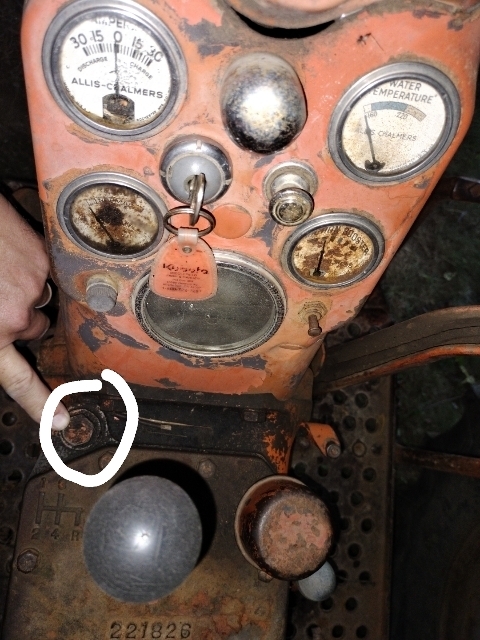

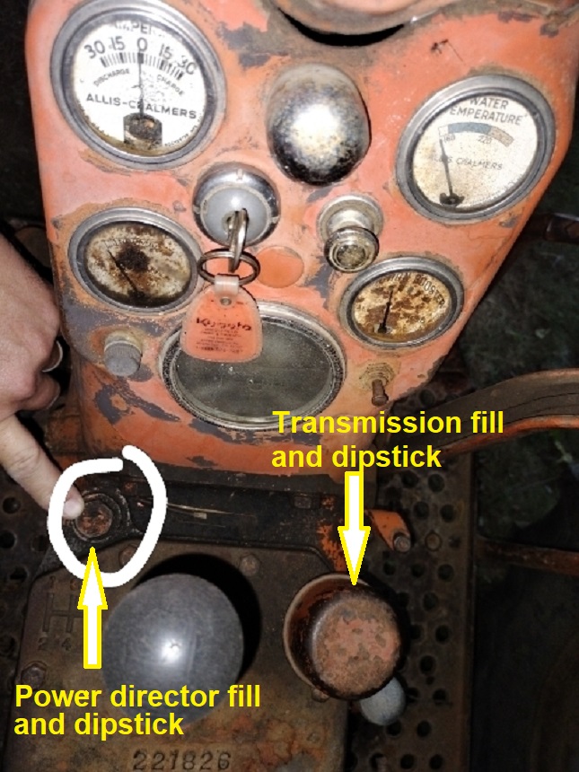

Left of gear shift is white circled bolt to add 2.5 gallons and white circled dipstick cap to add other 2.5 gallons?( Can I put all 5 gallons in district fill area or no?)

There are TWO compartments. They each hold approximately 2 1/2 gallons of oil each.  Use the dipsticks to verify.

As an example my manual points at the steering wheel where to fill the clutch compartment. Plug to the left of the gear shifter is in the same compartment as the dipstick for the transmission? I just want to make sure I'm putting the oil in the right place you know... I think my manual shows eight and a half quarts for the clutch and 9 and 3/4 quarts for the hydraulic pump(my dipstick says with hydraulic Rams extended, I don't have hydraulic Rams just lift arms (in my scenario does extended mean up or down on the lift arms) (I'm assuming the plug to the left of the gear shifter must go through a passageway into the clutch area and not straight down into the transmission and I fill the hydraulic pump through the dipstick opening)? Not everything is cut and dry when comparing my manual to what I have on my tractor...

To further define DR Allis's pictures for you.
The power director compartment and the transmission compartment are opposite sides of a "wall" inside the casting.  Both dipsticks go straight down into their respective compartments.

Okay excellent that's what I needed to know! Thank you very much for the details and clarification...
I kept wondering why they were saying there was a dipstick for the clutch when there's only a hex head exposed (I didn't know there was a dipstick under the hex head, I'll have to look tonight)
