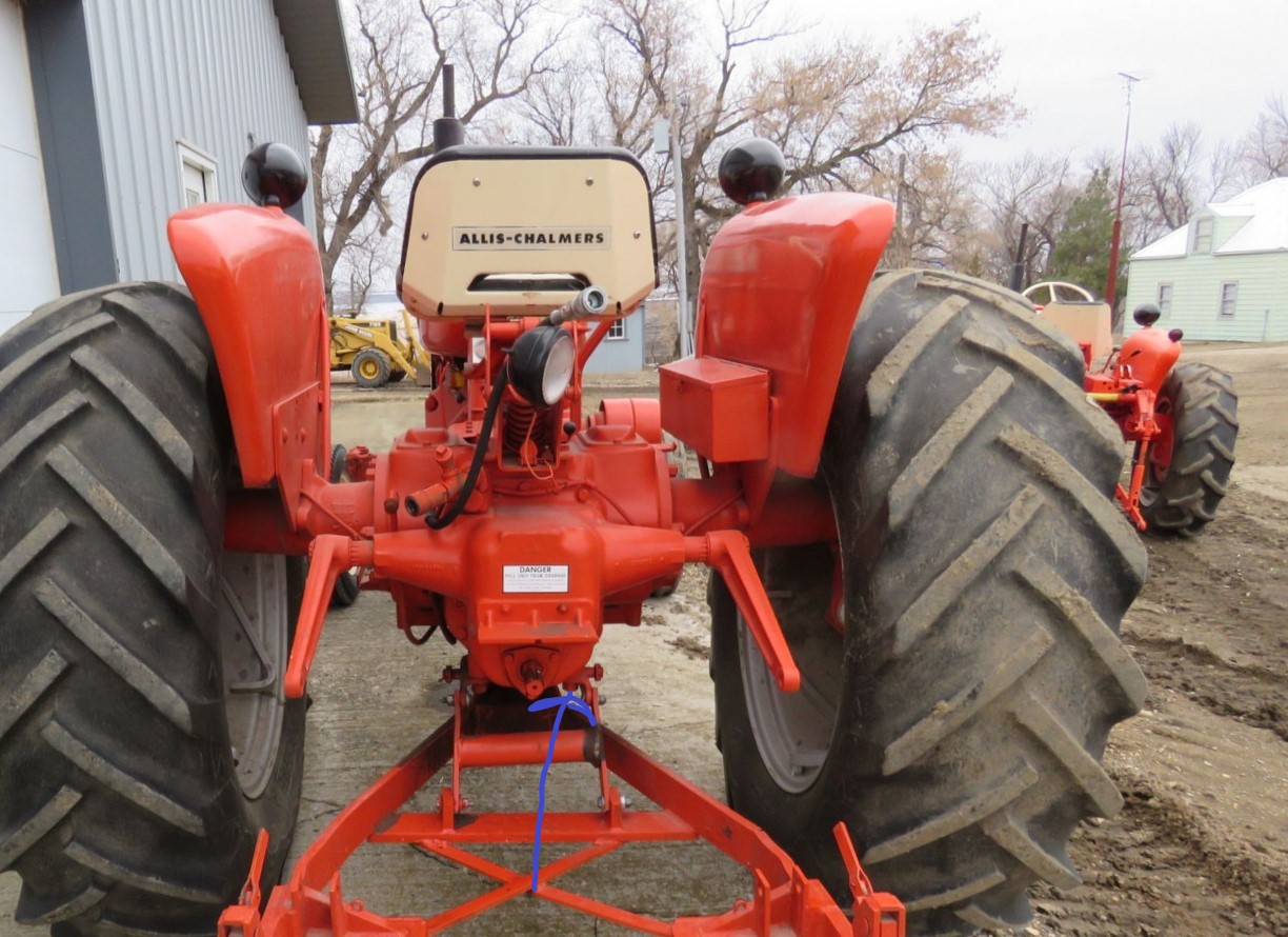

D17 Series III - Needing to know the bolt size for the two bolts that holds the plate to the housing for connection of the drawbar.  The plate has the PINS the drawbar slides on the tractor.  Have attach a picture.   Thanks for any help.

I going to say they are 3/4" NC diameter by 2 1/2" long- grade 8 quality and use a hard flatwasher, not a lock washer.  The length is a guess on my part but close. They need to be TIGHT or they will work loose.

“….3/4" NC diameter by 2 1/2" long- grade 8 quality and use a hard flatwasher, not a lock washer. ”
Grade 8 is probably overkill, as the material you are screwing it into is cast iron or cast steel. Tightening a grade 8 bolt enough to stretch it properly would maybe strip out the housing.
I agree with not using a lock washer.   But I would use loctite on those capscrews rather than trying to torque to a grade 8 spec. Go to about 200 lb-ft for a 3/4” screw with loctite.

After s # 24001 they used studs lock tight them in much better the bolts
Curious here. Are you saying that the bolt must be under tension to achieve its full strength?

The way it is made, I would say you need to retorque the bolts every time you use it.                              MACK

“Curious here. Are you saying that the bolt must be under tension to achieve its full strength?”
No, strength is not improved by stretching, but helps keep it from loosening.

“After s # 24001 they used studs lock tight them in much better than bolts..”
Agreed. Much less likely to strip the threads in the casting also.
