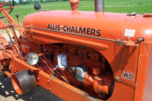

I would like to ba able the radiator shutter, not from the manivella, but directly from my seat, at the dash board. Like a remote shutter control.
I saw some modificationl ike that. Does there is any description on the forum. Or possibility to buy kit available on the market?

Interesting. I wonder if that was an aftermarket/non-AC kit? Those are pretty nice to be homemade.
I would be surprised if you could find anything new, but maybe someone has a used one they took off of a parts tractor.

I would say it is home made.  It looks nice, but totally ineffective.  It gives very little rotation on the crank, meaning the shutters actually move very little (if any).  On my CA I need to turn the crank around several times to get the shutters to open or close completely.

I think it is giving translation of the axle of the shutter, not a rotation on the screw

Post Options Post Options   Thanks (0) Thanks(0)   Quote Gary Quote  Post ReplyReply Direct Link To This Post Posted: 19 Jun 2022 at 5:03am
I agree with John. It looks like the Crank / Turning of the handle has been modified to a Push / Pull function.
