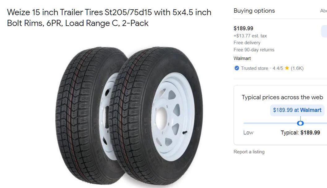

IBWD, those trailer tires you have on your CA?? Can you tell me what size they are? And the rims?? Did you have to alter them to get them to bolt up?
Points: 90800
Post Options Post Options   Thanks (0) Thanks(0)   Quote steve(ill) Quote  Post ReplyReply Direct Link To This Post Posted: 29 Jun 2022 at 9:12pm
the rims on a B-C-CA are 15 inch, 4.5 inch bolt pattern... normal rims are 3 inches wide for 5 inch tire............. You could put TRAILER RIMS on that were 5 x 15 inch with 4.5 inch bolt pattern and then use 6 -7-8  inch tires ( 175 - 205 mm) .... or similar  ...... CENTER HOLE 2-3/4 inch or bigger..

Thanks Steve,you answered the question I had about the rims

Tom, they bolted right up. Guessing Steve got your question answered. I've been on vacation in Canada and didn't have internet or would have replied earlier.

Post Options Post Options   Thanks (0) Thanks(0)   Quote TomC Quote  Post ReplyReply Direct Link To This Post Posted: 04 Jul 2022 at 11:05am
Thanks, I'll grab a couple of them for mine
