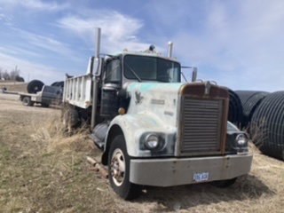

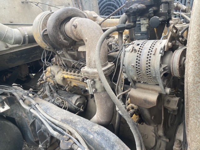

I am looking for some information on a 1673 Caterpillar motor that is in our old dump truck. I have been wanting to get it up and running again but have had little success. It ran when parked. (20 some years ago)
It turns over and will fire with a snort of either but won’t run on it own power. I have found little to no information on the internet on the 1673 motor. I do have a service manual for it but am striking out on making it run.

I am having trouble getting pressure out of the main pump. Not sure if it has a manual shut off as well as an electric run/ stop. It’s been too long since I ran it to remember.
Injection cups are cleaned and have a good spray pattern. No real decent pressure at the injectors though.

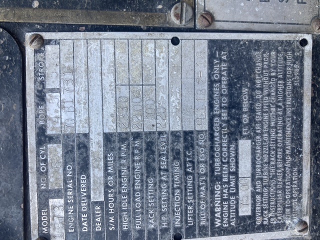

I see on the data plate "rack setting" so I'm sure it's got the diamond shaped plate on the side. That's where you attach the rack travel gage.

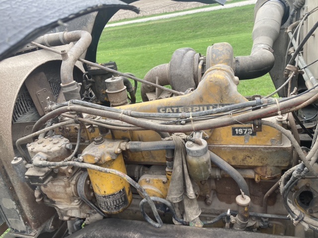

You don't need a rack gage just be able to see the rack. Can't see that area in your picture. Trying to find pic on the net.Found a grader engine(1673) and looks like maybe a hex plug on front is where the rack is...poor picture. There should be fuel in and fuel out lines for fuel manifold of pump and it has to have fuel in it for the plungers to draw from.

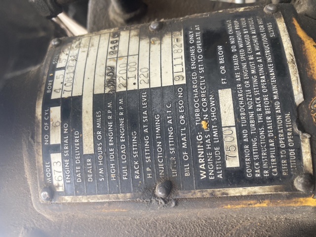

If you would shoot me the last 6 of the VIN is I can run it in the system and see exactly what we are working with

Engine plate
ditchman24 View Drop Down
Joined: 22 Jun 2017
Location: Watkins Iowa
Points: 108
Post Options Post Options   Thanks (0) Thanks(0)   Quote ditchman24 Quote  Post ReplyReply Direct Link To This Post Posted: 13 May 2022 at 12:31pm
Couple more of engine

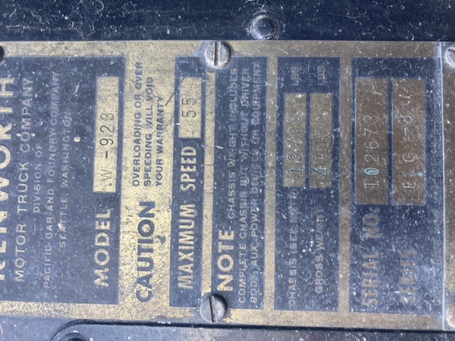

Door tags.
