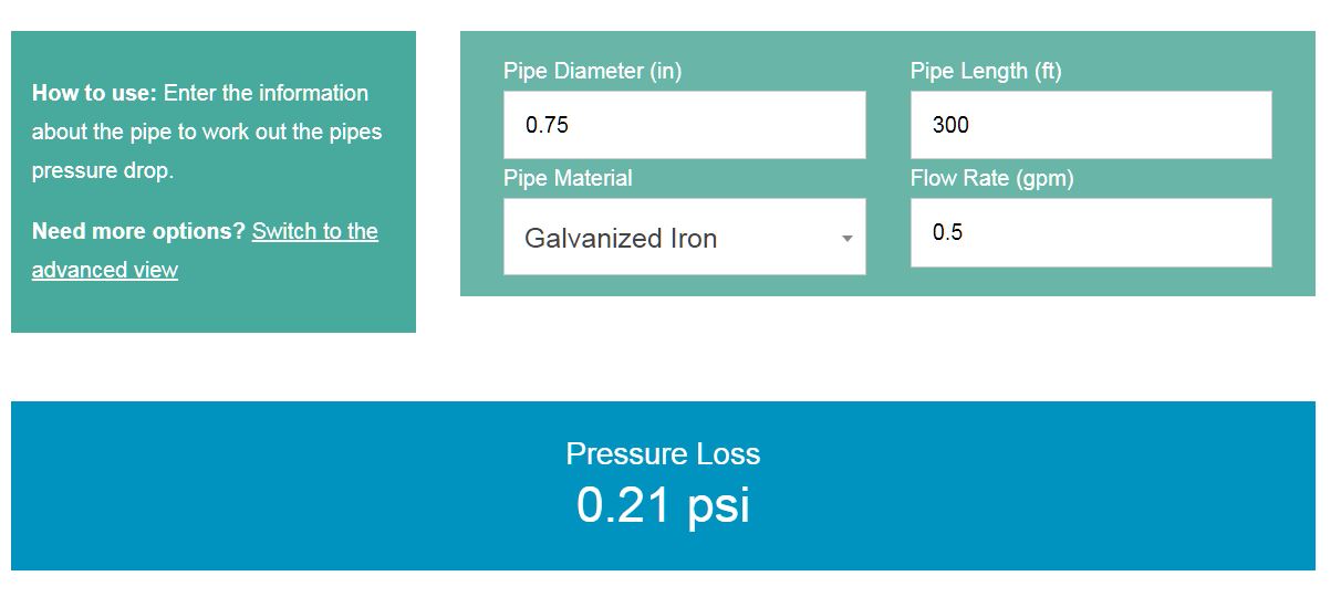

Here is an online calculator.... LEts say a 1 inch steel pipe has a 3/4 inch ID... and your running 300 ft... and your flowing 1/2 gallon per minute .. this is WATER, but you get the idea.......... pressure drop in the line is basically nothing at that small flow.... you can punch in other numbers and see results ( possibly a 3/4 inch OD pipe, etc)

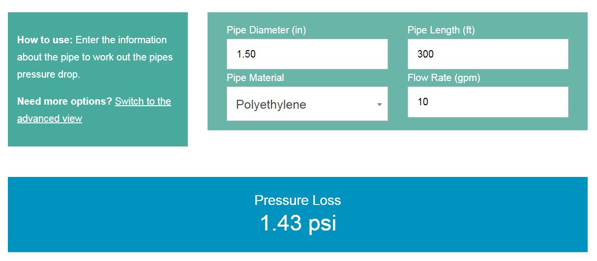

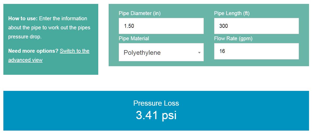

DEpending on HP of each.... if you assume 60 GPH each or 1 GPM... then lets say 16 GPM for the  15 motors... you "press drop" goes up a little ... If you have a 10 ft head or 5 psi... your getting down low, but still have positive flow.... ( remember, the hose has 16 GPM flow out of the tank..... but half way down the line, after feeding 8 motor, you only need 7 GPM flow for the remaining, so your Delta Press would be less)..
