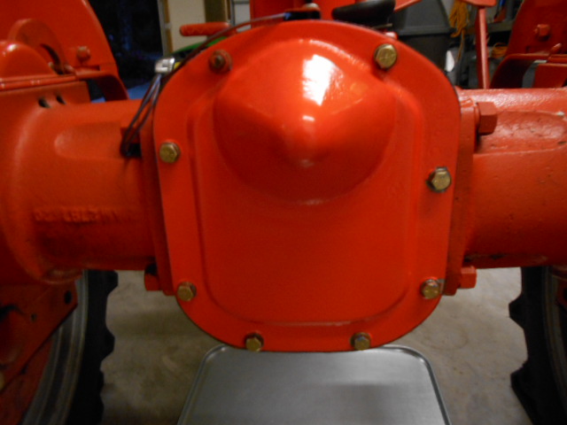

Here's my B with the PTO delete cover installed.  It has the pointed cover.

Post Options Post Options   Thanks (0) Thanks(0)   Quote Bill Long Quote  Post ReplyReply Direct Link To This Post Posted: 26 Mar 2022 at 3:06pm
You know all the new B's and C's were delivered with these deletes on them.
Since everyone wanted PTO Hydraulic they were removed.  We, and every other A-C dealer had TONS of them.
Good Luck!
