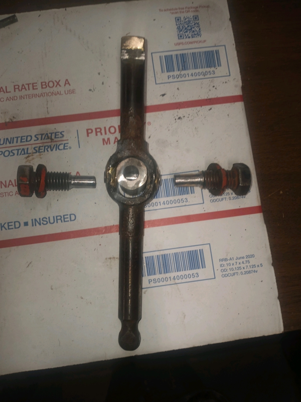

I installed the repaired shifter last week, it sure works smooth and tight now Smile
I brazed the holes up solid and drilled new holes to be a slip fit for the 3/8" roll pin. The center piece was hopelessly worn out so I made a new one and drilled it for a tight fit on the roll pin.
The side support bolts were quite worn so I built them up with brazing rod, then hand-filed them to a nice sliding fit. This took a couple of hours per bolt, but lacking access to a lathe now that I am retired I took the cheap way out Big smile
I expect this to outlast me.Tongue

hope your roll pin works , I used a piece or drill rod for cross pin - then made bolts on lathe and ground a relief in drill rod for end of bolts to index into to retain the rod .
  Then whatever works is better than a worn unit .

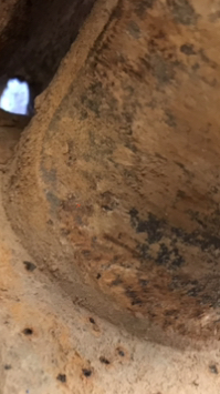

Thank you for posting these pictures. I would like to make this repair sometime soon on a HD5G that I acquired last fall. The shifter is completely loose and very hard to get in gear.
Was also taking a closer look at the bushing wear on track and was curious if anyone could give their opinion on how much is left on this bushing before it gets to exposing the pin?
It seems like at least a good 1/8 inch or more  of material has worn away- I would imagine that they should be at least turned soon-
 before its too late.

It's to the point DO IT NOW before it wears through .

Your pins/bushings need to be turned RIGHT NOW! Do not pass Go, do not collect $200

Right!  looks like there right on the edge of wearing through, Thanks for the links to the shops- Its a shame they weren't turned before, it looks like the sprockets and pads barely have any wear and seem to have been replaced somewhat recently.
