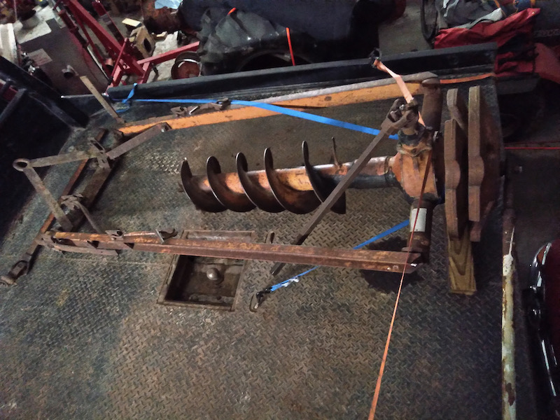

I picked up a Roper PHD today. I have a lot of limestone close to the surface here, so it's probably not going to be digging the holes for my next pole barn, unfortunately. I have some spots in the fields/pastures where it'll get put to work though.
I think it's mostly there (unfortunately the parts books I have don't cover the post hole diggers at all) with the exception of the handle, which is a homemade deal that I presume was done to allow the weights to be hung on top of the gearbox. I guess I got two WD/WD-45/D-17 rear weights out of the deal, too.
The auger tapers from ~10" at the bottom to ~12" at the top... I presume that makes this a 10" auger? The gearbox isn't frozen up at least.

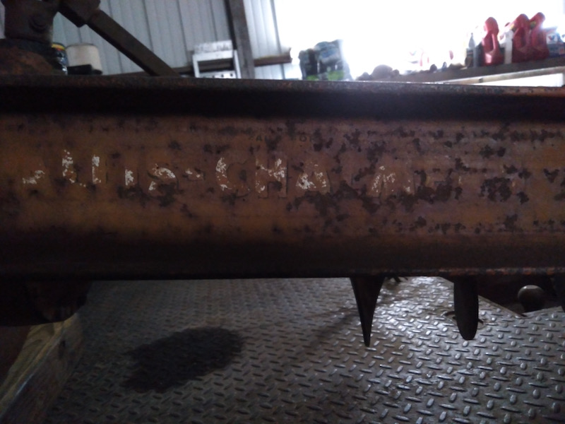

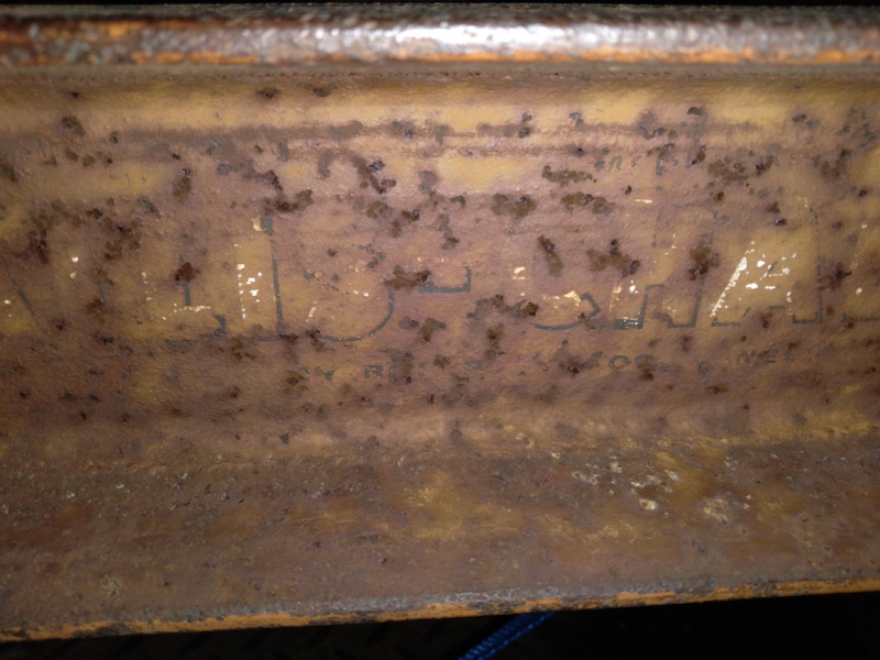

I thought it was neat that enough of the decals are legible to make out "MADE FOR" above the Allis-Chalmers logo, and "BY ROPER..." underneath.

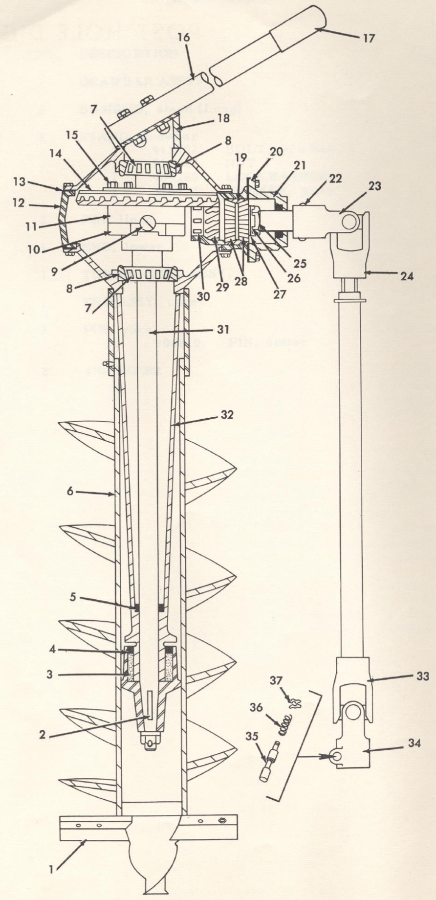

Huge thanks to Dave for the PDF of the manual. I tried to downsize it enough to post it on the forum but couldn't get it under the 2.0 MB limit for attachments.
Here's a cross section of the gearbox and auger for anyone that's curious. You'll note it's a very different design from most of the modern augers that are just pinned to the output of the gearbox... Which makes finding an off the shelf replacement auger probably impossible. If a guy needed to refurbish one, cutting off and welding on new flighting might be the only feasible option for these?
PS Item 22 is labeled a shear pin. Mine has been replaced with a bolt over the years. I suppose I ought to replace that with the lowest grade bolt I can find and step up from there if it shears too easily, since I don't know what material the original pin was made out of.
Edited by wjohn - 19 Feb 2022 at 10:09pm

2005030 is item 22 in the picture above

Pretty robust design. Straddle-mounted pinion. Really large spacing on the output shaft bearings.

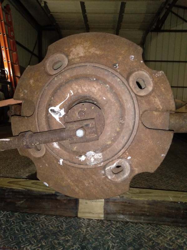

I am super thankful to be able to find this post on the roper post hole digger. I have this exact one and am rebuilding it. My question is, does this take gear lube/oil or grease on each bearing and gear ring? I do not see a seal on the auger/output shaft that would retain oil. On the other hand, I only see two grease fittings, one on the input bearing and one on lower auger sleave. My guess is that you pack each bearing and the ring gear with grease and close it up. Or just pack entire gear case with grease as there is about a quart worth of space. Any input would be appreciated.
 I am pretty sure these were made from 1930s designed ford differentials, because the bearings are ford differential bearing from this era was made by Timken 18-4221. The old ones I am replacing are Timken 18-4221 with the fork logo on them. Also the differential looks just like the gear case on my roper post hole digger.
Thanks for letting me join and ask questions. I have it apart right now and can post a ton of photos if anyone is interested.

I figured it out, I think, and solved it the hard way. At the bottom of the shaft near the end of what Ford calls the torque tube (1936ish ford light truck differential) there is a 3-piece felt oil seal indicated by #5 in the diagram. The felt was shot so I removed the seal components. I found a modern oil seal that worked and inserted it into the same position. I had a bunch of oil seals on hand and found on that worked.  The shaft did not have a smooth polished area for the new seal to run on, so I created one. I did this by mig welding a band of material to build up the area the seal would run. I then roughly removed the high spots of the weld with a grinder. Then I used my 1950's long bed lathe and turned the bearing sealing surface down, finishing it up with progressively finer sandpaper. This should do the trick, but we will see.
