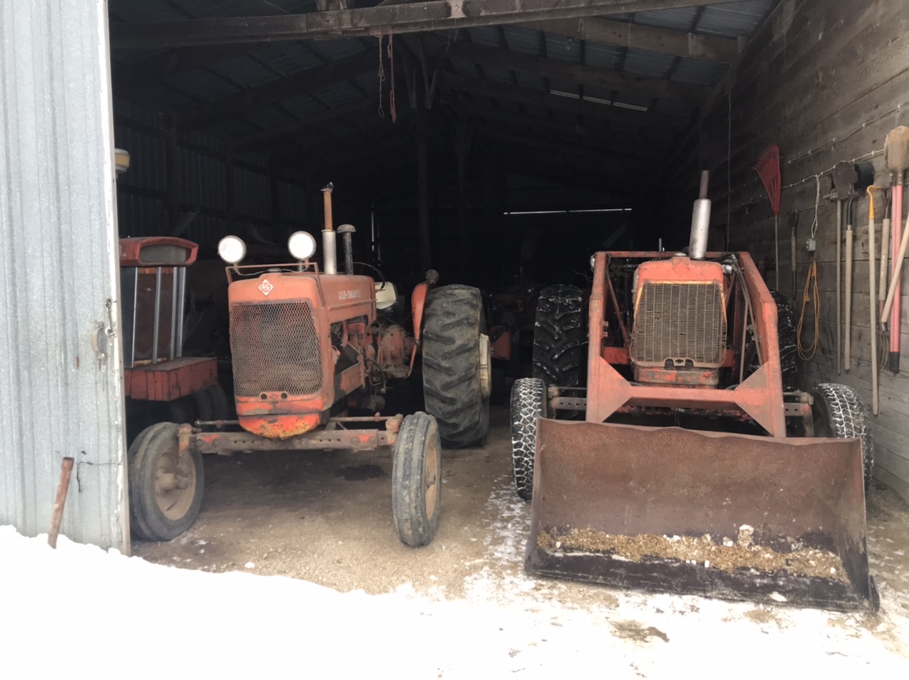

It can be 20 below out and the D-17 (gas) will fire up. I got a 200 that needs either to start at 70!

If you’re unhappy with how the D21 starts, I’ll take it off your hands

Post said 200 needed either - not D21

He was joking about the D21 because he wants it lol. As far as the WD on 6V, as long as you have good connections, good heavy cables, good generator and battery that 6V system will spin her over fine. I replaced my cables with 1/0 wielding cable and what a huge difference it made.

As far as your 200, sounds like your pump needs a rebuild if it starts that hard at 70 degrees or you have low compression.
 There is a D21 with it's nose just showing in the picture.
