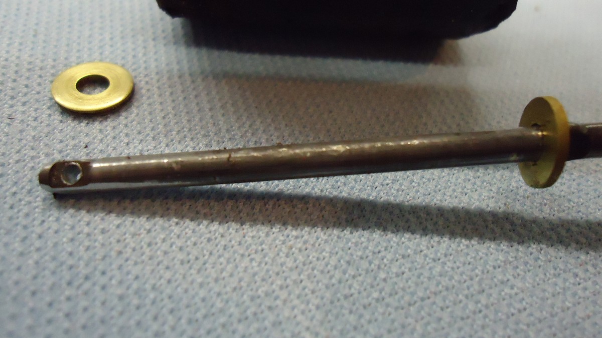

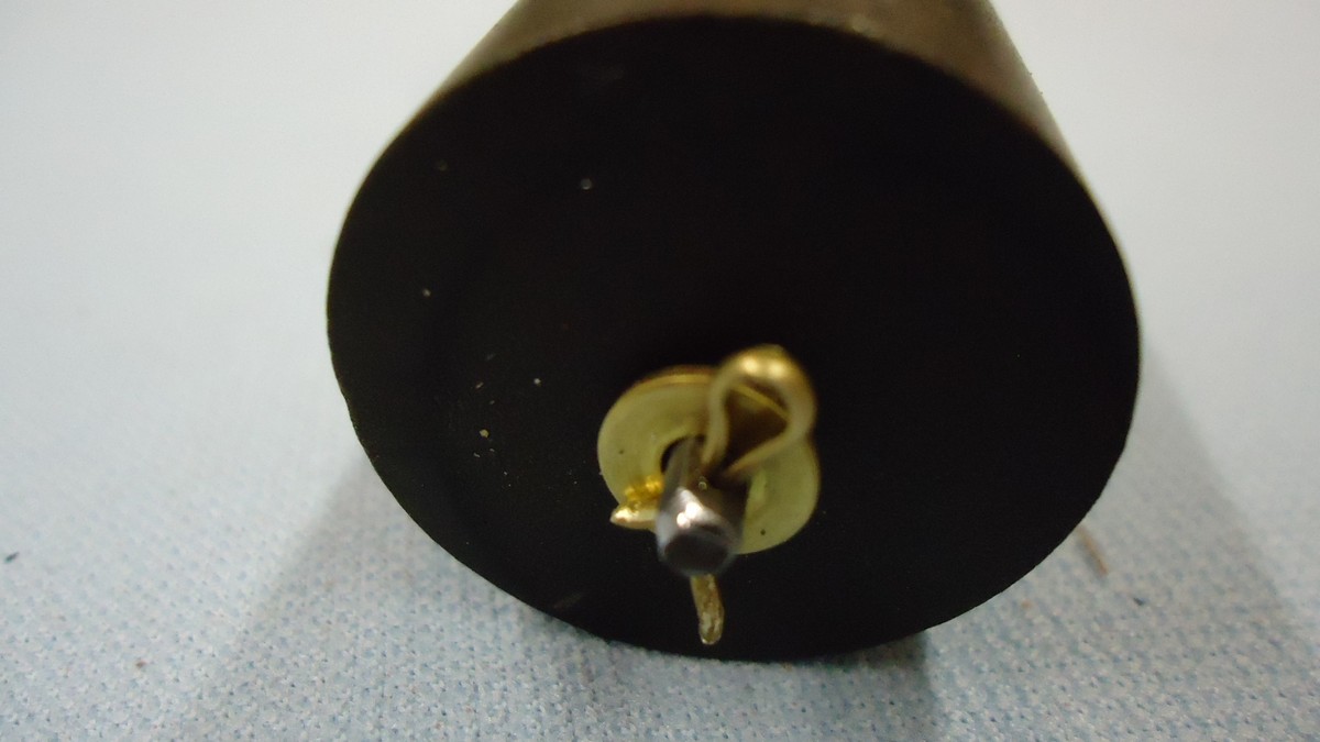

here's a thread on gauge floats;
https://www.allischalmers.com/forum/d17-gas-gauge-float_topic116387.html
OR, a Model A float ; Ford #A-9313-C works very well.
It's what I used on my D17sIV
A bit of modifying is in order, but it can be done with ordinary tools and a drill.
IIRC, the open end is swedged to retain the float.  Just have to use a small hammer and "re-round" it, then file it down smooth 'til you can remove the float.
Drill a small hole for a brass cotter key in the same area to keep the new float on;
used 2) brass washers , one on either side of the new float.
If you don't like buying Chinese, buy from Norm as in the thread above.

Great pictures! I have small copper washers and steel Cotter pins on hand. But I'll try to find brass if that's going to hold up better.
As I mentioned, my float had already fallen off the rod and there are no washers left, must have disentegrated over the years. I will take a closer look at the rod. Seems like it just had flat spots, indentations, not flared out beyond the round shape (if that makes sense). Maybe the flare is so minimal that it's not obvious.
