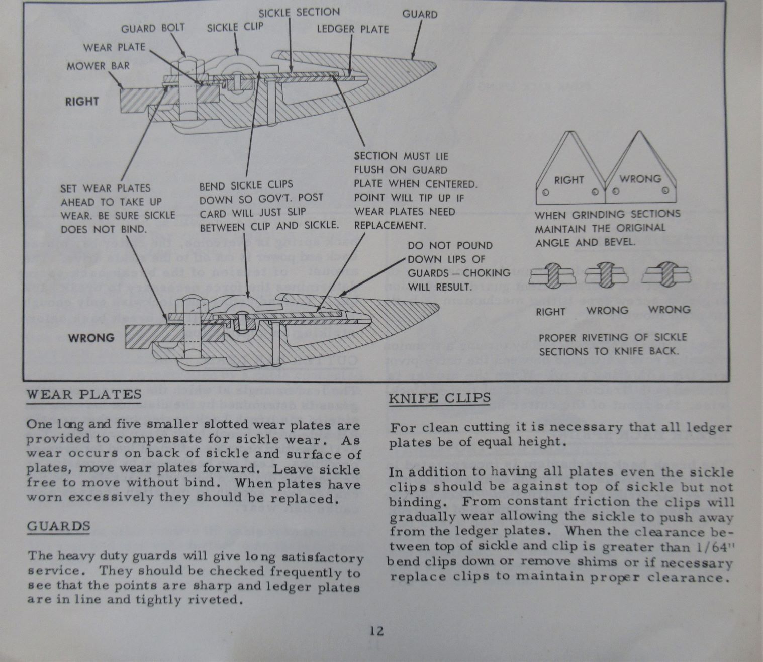

The original A-C wear plates were of different lengths. Here are diagrams and instructions on adjusting them.

Points: 1172
Post Options Post Options   Thanks (0) Thanks(0)   Quote Hunt4Allis Quote  Post ReplyReply Direct Link To This Post Posted: 08 Oct 2021 at 8:43am
I don't see washers needed in between hold down clips and wear plate?

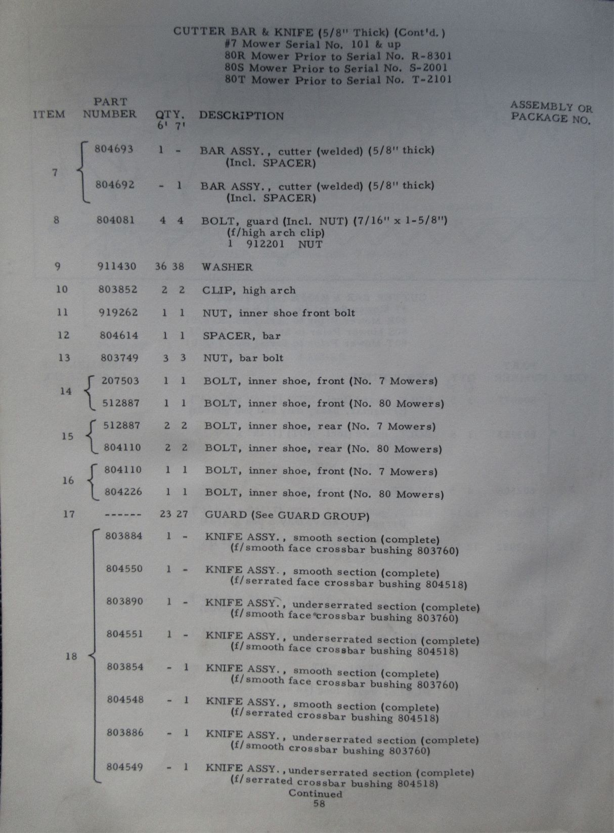

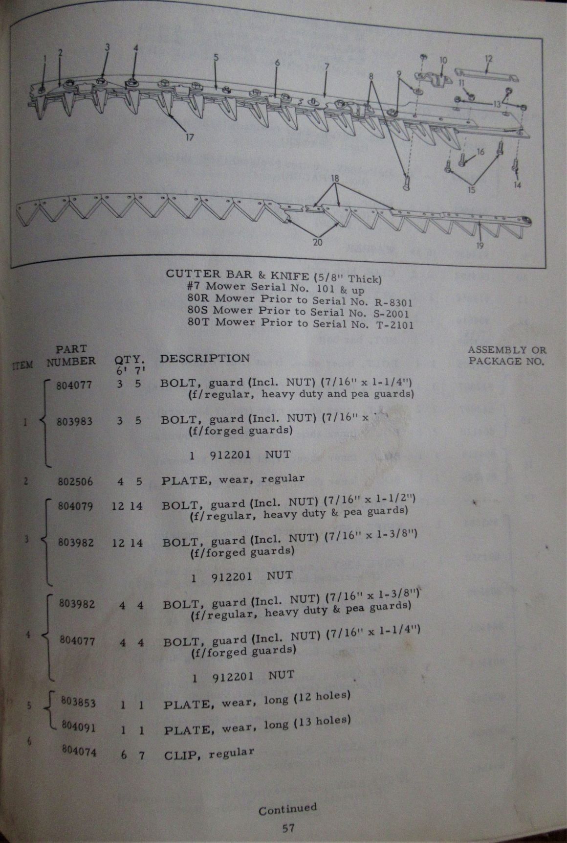

Points: 8738
Post Options Post Options   Thanks (0) Thanks(0)   Quote Mikez Quote  Post ReplyReply Direct Link To This Post Posted: 08 Oct 2021 at 9:08am
Brian post the next page where it shows #9 the washers. Qty 36 or 38 part number 920310 or old #911430
Edited by Mikez - 08 Oct 2021 at 9:09am
Brian G. NY View Drop Down
Location: 12194
Points: 2269
Post Options Post Options   Thanks (0) Thanks(0)   Quote Brian G.  NY Quote  Post ReplyReply Direct Link To This Post Posted: 08 Oct 2021 at 2:04pm
Here you go Matt. Page 58

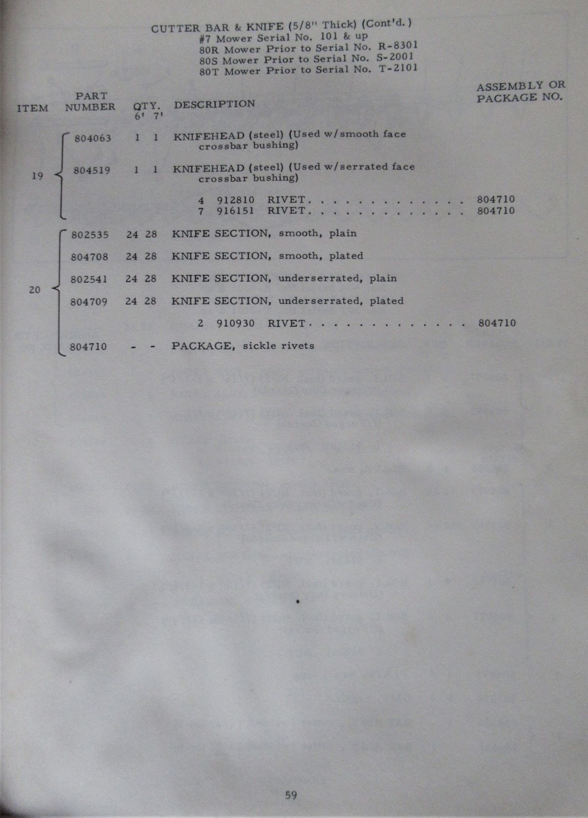

Location: 12194
Points: 2269
Post Options Post Options   Thanks (0) Thanks(0)   Quote Brian G.  NY Quote  Post ReplyReply Direct Link To This Post Posted: 08 Oct 2021 at 2:09pm
And....page 59
