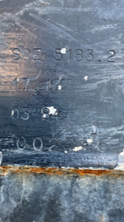

The data plate should have a model number and a serial number. One of those numbers should have an N stamped behind it to signify it is a no spin.

uploads/22091/8070_front_axle_data_plate.PNG
Don't know if I did this correctly (supposed to be a pic).
I don't see an "N" but of course, they couldn't be bothered to put a little Vaseline or tape over the plate when they painted.  Thanks for the help.
