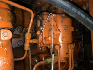

Post Options Post Options   Thanks (0) Thanks(0)   Quote Mikez Quote  Post ReplyReply Direct Link To This Post Posted: 21 Aug 2021 at 8:34pm
try taking the little fitting out on top of pump. It’s the return line and in that fitting there’s a little ball as the check valve. See if there’s junk stuck up in that fitting. If so try cleaning it. You can ether clean and try it or that ball is glass and can be broken out of there. But if there is stuff in there it usually means the pump needs to be rebuilt as the junk your finding is pieces of the flex ring.

Post Options Post Options   Thanks (0) Thanks(0)   Quote tycoon7 Quote  Post ReplyReply Direct Link To This Post Posted: 21 Aug 2021 at 9:03pm
Thanks Mike. Can you tell me from this picture on what fitting your referring to?696E153C-F1D7-4869-837C-597CBE01B43D.jpeg

Post Options Post Options   Thanks (0) Thanks(0)   Quote MACK Quote  Post ReplyReply Direct Link To This Post Posted: 21 Aug 2021 at 9:04pm
First thing, loosen the two screws in timing window on side of pump so fuel leaks out. Run it a while with fuel leaking out. If it runs OK then, it is time for a pump rebuild. Weight retainer is coming a part . Ed on here can fix you up.               MACK
