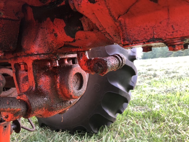

Originally posted by Fred in Pa Fred in Pa wrote:
Hyd. drain is easies place to put it , unless you want to drill a hole in top or side of housing .Where do u want your return hose  laying
I see someone added a nipple on the bottom at some point of life, do you think this would work or should dump in from top?
allisbred View Drop Down
Joined: 28 Mar 2015
Location: Hanover Pa
Points: 1011
Post Options Post Options   Thanks (0) Thanks(0)   Quote allisbred Quote  Post ReplyReply Direct Link To This Post Posted: 21 Jul 2021 at 7:12pm
That might be to the transmission, I need to look at that again.
