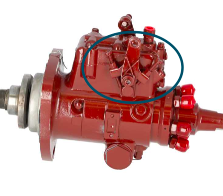

My plan is to push the throttle open when the engine is off and see which screw it is hitting. I then plan on adjusting that screw only to prevent the throttle from going that high. This sounds like a simple fix in my head. If not I might take it to a shop and have them mess with it.

Post Options Post Options   Thanks (0) Thanks(0)   Quote injpumpEd Quote  Post ReplyReply Direct Link To This Post Posted: 08 Jul 2021 at 7:56am
Sometimes the linkage gets adjusted so excessive pressure is put on the hi idle screw, and the boss on the throttle arm can break off, thus having no hi idle stop. If that were the case, re-adjust the linkage to pull it to the needed amount, and go from there. A low cost photo tach can be bought online and is very handy for verifying rpms.
